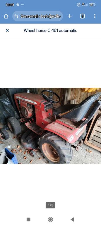

Hello ,
Is there difference between transmission C160 and C161 ( K341) ?
- Perhaps C161 has a Eaton 11 ??
I cannot find in the documents
Thanks for your answers

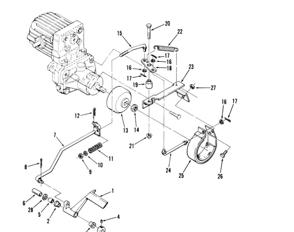

The 161 might have a drum for the brake. A 160 will not.

The C-160 should have a Sundstrand #90-1140.
The C-161 should have a Sundstrand # 90-1173.

The C-161 had a physical brake on the hydro unit,  Making for different Sunstrand #

As noted by others, the C-161 has sundstrand model 90-1173---with an external brake drum. Aside from that, the Sundstrand  Piston-to-piston models 90-1136, 1137, 1140, 1172, 1173 are internally near identical.  I have successfully rebuilt MANY of them and have made available a FREE download of the overhaul process.   The sundstrand Hydro-gear 90-2046 is also an easy rebuild...as is the GT-14 model 90-2062.  There are also gasket and O-ring kits available via Red Sq vendors.

The C-160 will have the internal parking brake...The C-161 would not have it.  With any 50 year old hydro you really want to test it before buying.  Run it around get it warmed up then chain it to a tree or put it up against a wall and see if she will try to dig in the rear tires.
