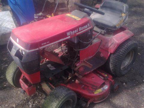

The original engine was lost when i found this 518he in south west of Finland near Turku. before i made the deal i had located a similar engine with two horse(s)power less. Im no electritian, but compared the electrics of the new engine to the old, it raised more questiones to me than it realy was as my electritian pal just got the micros switches to connect and wires and changed the solenid to a relay. And now works perfect. I was nervous it would leak oil from some of the hydralic lines as it was pretty oily and greasy when i bought it, it was probably only the old engines oil drain tube that was loose and had been so for a long time till it killed the engine i belive.

Wonderful news!  Attaboy!
953 nut
:WRS:
It is always good to have a friend or two to help you with subjects you aren't fully informed about.      :handgestures-thumbupright:        Glad you were able to make the old Wheel Horse come to life again.

Is the clicking sound normal or is it the hydrostat
Blasterdad
It sounds like it might be the parking brake lever rattling, I can't see it from the camera angle & your video is only 5 seconds long. It's hard to tell...
  • Like 1
Richard_S
Or the tension arm for the engine/hydrostat belt
  • Like 2
