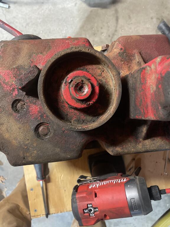

1968Commando 52 #1 Posted March 15 Hello, I am putting a new brake drum shaft seal in a transmission and cannot get the drum removed how do I go about this? The transmission is a 5053 uni drive Share this post Link to post Share on other sites

rmaynard 15,874 #4 Posted March 15 (edited) Usually when a brake shaft seal is leaking, the oil that seeps out will lubricate the shaft enough that the drum will slide off with ease. This is a dumb question, but did you remove the snap ring? It looks like you did, but with the dirt it's hard to see definitively. As others have said, use a good penetrating oil. Not WD40. That drum is pretty easy to get a gear puller behind it if need be. Edit: Pullers are available for free from Advanced Auto Parts and Auto Zone. Edited March 15 by rmaynard 2 Share this post Link to post Share on other sites

stevasaurus 23,012 #7 Posted March 15 This is probably to late to say, but I would take off the "C" clip and give a good cleaning to the end of the shaft. If I felt chipped metal on the shaft, I would lightly file those. Then I have used a 2' pry bar tapping and working it around while prying off the drum. That has always worked for me with no damage. If you really have a stuck one, try using a large 1/2" drive socket over the shaft and tap the drum toward the transmission (or a big punch) to break the drum loose. Once broke loose, a puller or the prybar should work. Share this post Link to post Share on other sites

1968Commando 52 #12 Posted March 16 (edited) Hello all, I have been spraying it with pb blaster and hitting it still having issues going to keep spraying it periodically during the week and then next weekend I will try and get it off hopefully I will keep yall updated I have gear pullers but I cannot get them under the drum as there is not enough space between the gear case and the drum to get the fingers in there. Edited March 16 by 1968Commando Share this post Link to post Share on other sites
1968Commando 52 #13 Posted March 16 On 3/15/2025 at 10:36 AM, rmaynard said: Usually when a brake shaft seal is leaking, the oil that seeps out will lubricate the shaft enough that the drum will slide off with ease. This is a dumb question, but did you remove the snap ring? It looks like you did, but with the dirt it's hard to see definitively. As others have said, use a good penetrating oil. Not WD40. That drum is pretty easy to get a gear puller behind it if need be. Edit: Pullers are available for free from Advanced Auto Parts and Auto Zone. Yes the snap ring is removed 1 Share this post Link to post Share on other sites
oliver2-44 10,201 #14 Posted March 18 On 3/16/2025 at 11:52 AM, 1968Commando said: I have gear pullers but I cannot get them under the drum as there is not enough space between the gear case and the drum to get the fingers in there. This is where the wedges work. Cut some from hardwood like oak if you don’t have any brass or steel ones. Share this post Link to post Share on other sites
