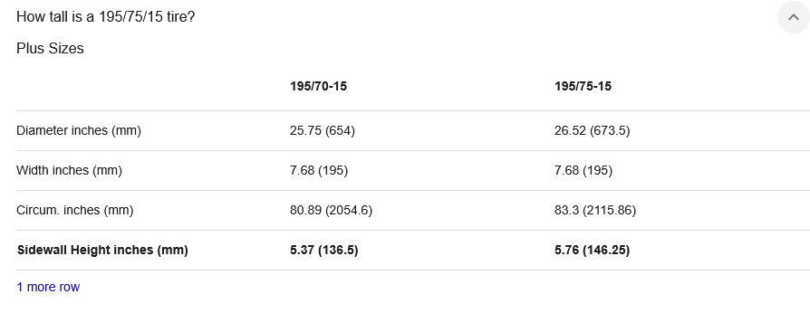

cafoose 3,383 #1 Posted March 10 What size ag tires would fit my 953? Cross reference seems to be 195/80/15. Some of the tires I see listed are for example 15 x 6.00-6. How does that translate to the size I need? What do each of the 15 x 6.00-6 numbers mean? Share this post Link to post Share on other sites

ebinmaine 70,672 #3 Posted March 10 25 minutes ago, cafoose said: 15 x 6.00-6 Can you post a link? That size > to me < means 15" OUTER diameter. 1 1 Share this post Link to post Share on other sites
ebinmaine 70,672 #4 Posted March 10 BKT seems to be making a good product from what I've read. I have some I haven't used yet. I personally use and recommend Simple tire. You'll find a 7.5L - 15 that measures just under 30" OD. There's also 5 - 15 and some brands of 6 - 15 that measure one side or the other of 26" OD. 1 1 Share this post Link to post Share on other sites

Lee1977 7,034 #7 Posted March 10 2 hours ago, ebinmaine said: Can you post a link? That size > to me < means 15" OUTER diameter. 15 X 600 X 6 As EB said that size tire is 15" outer diameter 6" wide and for a 6" rim. 750 x 15 would be 7 1/2" wide and a 15" rim. 1 1 Share this post Link to post Share on other sites
