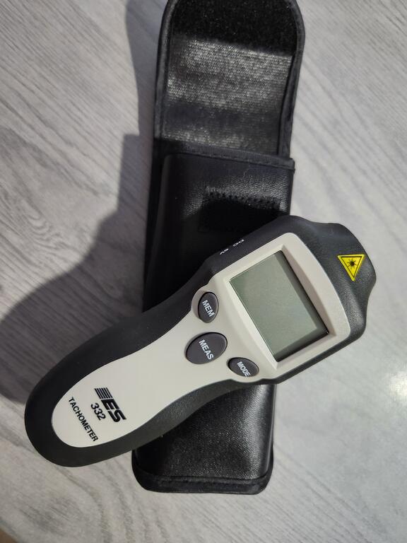

Retired Wrencher 5,599 #1 Posted yesterday at 11:29 AM What do you guys use to check Rpm`s. They have a laser type that makes it easy to use. Also I have my old automotive type but made for 6 and 8 cylinder engines. Any ideas are welcome. Share this post Link to post Share on other sites
Achto 28,320 #2 Posted yesterday at 12:05 PM 35 minutes ago, Retired Wrencher said: What do you guys use to check Rpm`s. this is what I use. https://www.harborfreight.com/digital-photo-sensor-tachometer-66632.html?utm_source=google&utm_medium=cpc&utm_campaign=21901739405&campaignid=21901739405&utm_content=173216750591&adsetid=173216750591&product=66632&store=820&gad_source=1&gclid=EAIaIQobChMImP_k9vLyiwMVtTatBh2mAARXEAQYASABEgKOvvD_BwE 2 1 Share this post Link to post Share on other sites
WHX?? 49,998 #3 Posted yesterday at 12:36 PM Avoid the cheapest in the jungle if possible. Not than they are all junk like the one I have. It works... when it feels like it and even then erratic. Read the reviews and advice from others here if they have one. Most are laser type with a piece of reflective tape stuck on the fly wheel (non contact) Some are convertible with a rubber tip to read right off the crank. Share this post Link to post Share on other sites

ri702bill 8,803 #7 Posted 19 hours ago 5 hours ago, Achto said: this is what I use. https://www.harborfreight.com/digital-photo-sensor-tachometer-66632.html?utm_source=google&utm_medium=cpc&utm_campaign=21901739405&campaignid=21901739405&utm_content=173216750591&adsetid=173216750591&product=66632&store=820&gad_source=1&gclid=EAIaIQobChMImP_k9vLyiwMVtTatBh2mAARXEAQYASABEgKOvvD_BwE I also - reflective tape on the engine pulley shaft on the 854, on the PTO Bell on the C81 (with PTO engaged). Works best in the shade, will NOT work in direct sunlight. 1 Share this post Link to post Share on other sites

Retired Wrencher 5,599 #13 Posted 2 hours ago 22 hours ago, Achto said: this is what I use. https://www.harborfreight.com/digital-photo-sensor-tachometer-66632.html?utm_source=google&utm_medium=cpc&utm_campaign=21901739405&campaignid=21901739405&utm_content=173216750591&adsetid=173216750591&product=66632&store=820&gad_source=1&gclid=EAIaIQobChMImP_k9vLyiwMVtTatBh2mAARXEAQYASABEgKOvvD_BwE Thank you. Does it work well? Share this post Link to post Share on other sites

Achto 28,320 #18 Posted 37 minutes ago 1 hour ago, Retired Wrencher said: Thank you. Does it work well? I've had pretty good luck with it. Its readings are right in line with the one that our pulling club uses to check us. Share this post Link to post Share on other sites
