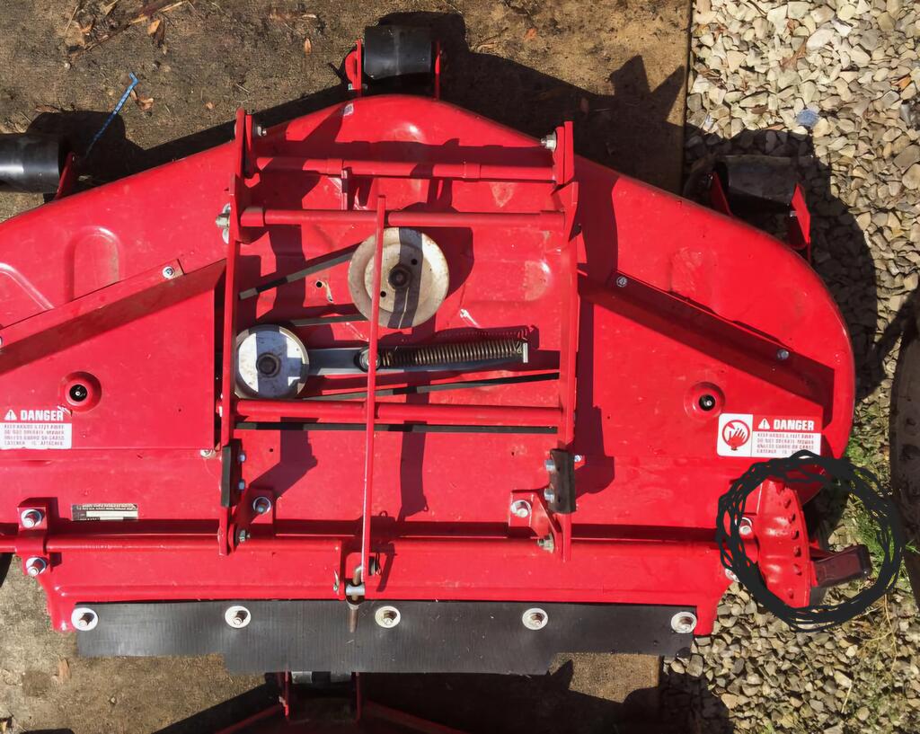

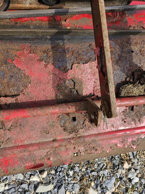

I'm wondering if there are any parts missing.  It's actually 2 welds, and I think I'll be patching the deck there and in some other  spots at the same time.  I think I with strip, wire brush or sandblast the whole deck, fill and level where needed, and repaint it.  Then put it in storage. 🤓
1st photo is deck label
2nd photo is without the loose parts
3rd is with the 2 parts I have, just loosely sitting (generally) in place.
  • Like 1

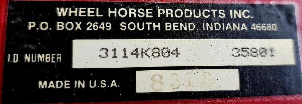

Model/serial#

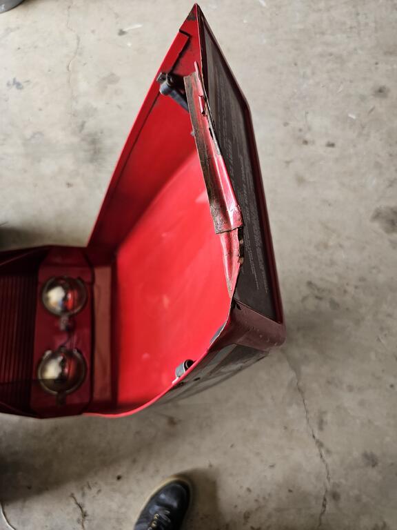

Damage to hood sheet metal.  I can get it into rough shape.  Not interested in perfection.

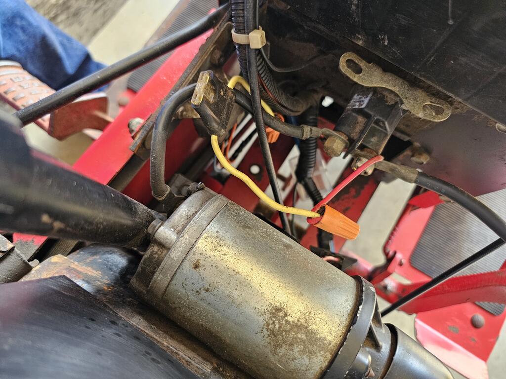

Wire nuts?  Really?!  Wiring to be done properly.  Also, looks like aftermarket relay, but it works.
300 CCA U series battery (UP1).  Still a flat spot starting.  Not a major issue, but I suspect the starter is bad, internally.

Lots of mower deck rust, plus good underside.  Clean rust, assess, fill & level, paint, store.

Here is the correct manual for your deck, pretty much the same, in your second pic of the deck the selector arm is upside down & the spring is missing. Is the selector quadrant what you're refering to as needing to be welded?

Here is the correct manual for your deck, pretty much the same, in your second pic of the deck the selector arm is upside down & the spring is missing. Is the selector quadrant what you're referring to as needing to be welded?
Yes, I believe it's the selector quadrant.   The part I circled, bottom right.
IMG_0105.jpg.d647be0d44209af0f4d091d04e6b9860.thumb.jpg.86ae163d85592ebd444813c8b8fb8cb4.jpg
I also see my LH & RH belt covers are missing. And the rubber flap at the back of the deck.
After I get it clean, welded, patched, & painted, I'll try to find them.

The quadrant is not welded to the deck, it bolts on under the axle bracket like the pic shows. :handgestures-thumbupright:
