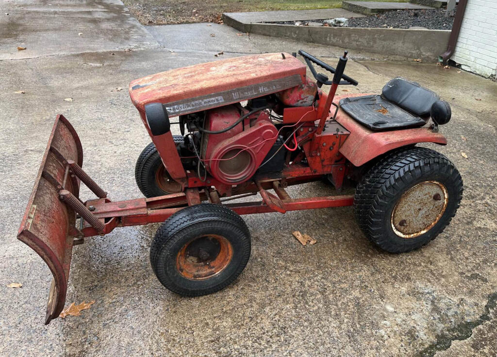

Starkman 20 #1 Posted February 21 I’ve just acquired a new to me 877 to putt around on. It runs (not great) but smokes a lot, has a very cool look, and I love the size of it. I’m gonna cruise around in here and, hopefully, end up with a neat little machine that I can enjoy with my grandson. 9 7 Share this post Link to post Share on other sites
953 nut 57,832 #3 Posted February 21 The short frame Wheel Horses are fun to drive, very maneuverable and able to push snow and tow just about anything. Jim @WHX?? has posted restoration threads on the 1967 models that will help guide you. Please ask any questions you may have, we are here to help. 2 Share this post Link to post Share on other sites
ri702bill 8,951 #4 Posted February 21 (edited) Welcome! Find the correct fuel tank and add an angled pipe elbow for the muffler the hood will latch. Speaking of latches - WATCH OUT for the seat pan latch releasing when you do not want it to! More than one RS Member has been pitched off the back! Fix that dangling wire, add a ground from the hood to the frame. You have a nice project tractor there. You may wish to look over the "New to Herd" thread geared to new WH owners.... Got questions?? Just ask.... Bill Edited February 21 by ri702bill 2 Share this post Link to post Share on other sites
WHX?? 50,681 #5 Posted February 21 Nice! A bucket list tractor for me. With the hydro an excellent blade tractor. 44 minutes ago, ri702bill said: Find the correct fuel tank Looks to be the correct tank Bill just not in the correct position. It can be a bugger to get down in there right with the gas cock attached... impossible with a sentimental bowl. Hopefully not missing the hold down strap but that should be an easy find. Cancell that just saw it hanging ther. Let us know if you need help there. '67 short frames did not have a angled pipe but strait out with a long enough nipple. Interesting wheel weights have a pair just like them. 2 Share this post Link to post Share on other sites

Starkman 20 #16 Posted February 22 The tank is correct, with the original band. I should have taken new pictures of everything back in place. I’m tinkering with getting it to run better, currently. It drove on and off my trailer, but that’s about all it wants right now. 2 Share this post Link to post Share on other sites

WHX?? 50,681 #20 Posted February 26 Carb cleaning might be in order ... @ebinmaine got your checklist handy? On 2/22/2025 at 7:23 AM, Starkman said: learn how to navigate this forum https://www.wheelhorseforum.com/forum/56-finding-your-way-around-in-redsquare/ 1 Share this post Link to post Share on other sites
ebinmaine 70,648 #21 Posted February 26 8 hours ago, WHX?? said: Carb cleaning might be in order ... @ebinmaine got your checklist handy? https://www.wheelhorseforum.com/forum/56-finding-your-way-around-in-redsquare/ Yep Share this post Link to post Share on other sites
