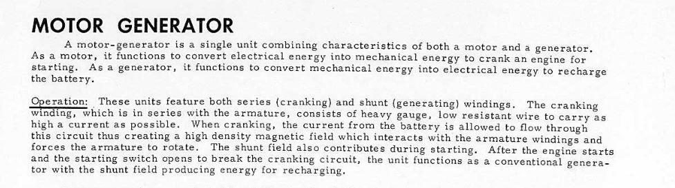

This S/G manual should be all you need to figure it out.

There are two windings...the start and the charge...the charge does assist the Start when cranking but the start does not assist the charge so your charge coil is probably bad.
