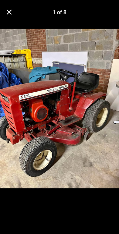

2 hours ago, ri702bill said:
Having both an 854 and a C81, there is a distinct wheelbase difference that should be considered when buying a tractor for the long term. You get more leg room with a C Series over an 854...... If you are over 6 foot in height, you tend to look look like the circus bear on the tricycle riding a round hood...!! and on an RJ!!!!!
Both machines are K181 powered, and as Don stated, that is ample horsepower even for a snowthrower too.
I'm 5'10", and I've just dropped to 161 - 6# to go!  So, perhaps a monkey, but not a bear! 😉😁
It's the (hopefully) rototiller I'm a little worried about, after some of the warnings, above.
Edited by Pete D

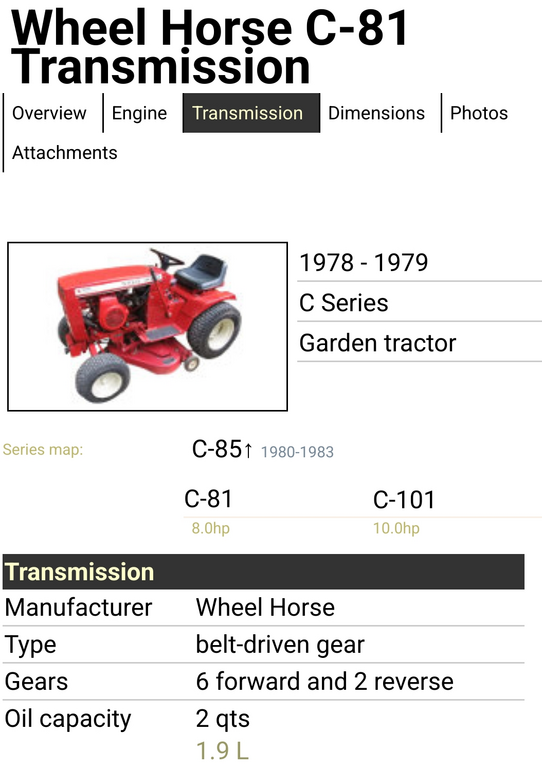

The C81 isn't BAD looking; it just looks like a lawn mower.  The 6 fwd, 2 Rev is the 8 speed trans?
Edited by Pete D
ri702bill
Yes. A rugged machine. A later version, almost exactly like the later B-80 8 speed model.
And, yes the 8 speed with its 4x reduction allows you to run WOT at a crawl for ground speed.... but I believe there is no substitute for more HP. Any 8HP model may struggle with the demands of a tiller...

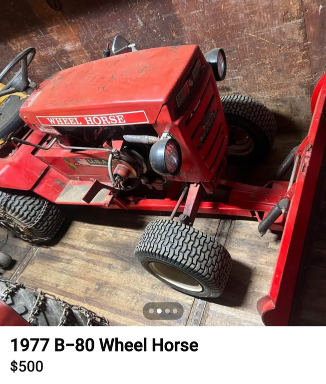

I saw this listed in my town.  Seems odd that it was listed sold, then relisted again.  But, since I'm in no rush, I will just keep looking,. As said, I really like the more "classic tractor" appearance, although function over form makes more sense.
Edited by Pete D
  • Like 2
Handy Don
Headlights and even a left side rear view mirror!
$500 might be a respectable price. Visually(except for the seat) it looks OK and the plow, rear wheel weights, and chains add value (a mowing deck isn’t a value add in your situation). Current condition and what you can learn of its history of use and how it was maintained would be the deciding factors. It appears to be parked next to another tractor.
  • Like 2
ebinmaine
If those weights are steel that's $200 just by itself. Half that for plastic ones. The plow looks to be decent. That's another $150 or so. Chains are worth 50 bucks.
  • Like 1

Here's what concerns me, and maybe it's a glitch + coincidence:
It looks like the same 8 HP B-80 sold, in his profile, 2x before.
I guess I could go look, we're in the same town.
Or, I can just keep looking and waiting until the June show.
Handy Don
As you surmise, some sellers tell the whole truth, some stretch the truth, and some utterly avoid the truth.
Looking with your default reaction as “no thanks” might be a useful exercise.
  • Like 4

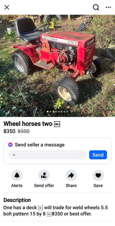

HyperPete
Can I keep throwing some out here without driving you all away from boredom?

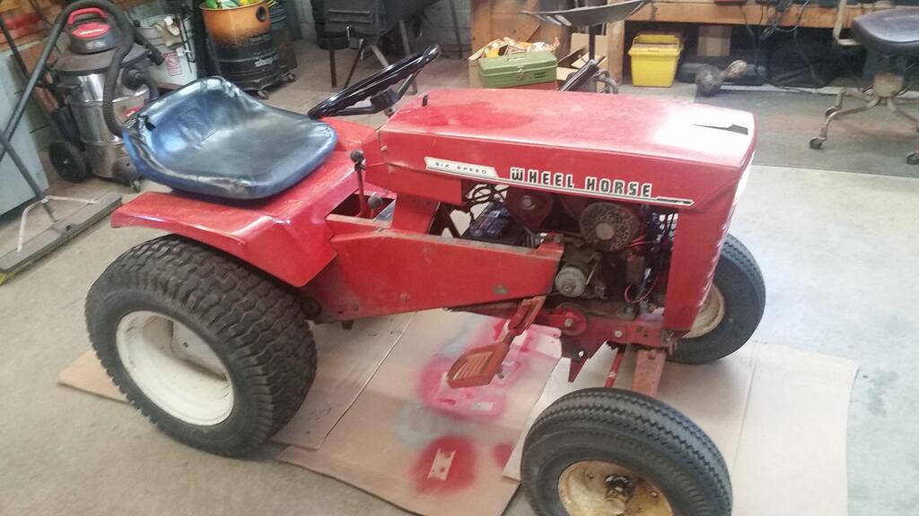

Here's another, at the bottom, with plow, but no weights and chains.  But I read that they are 3-speeds.

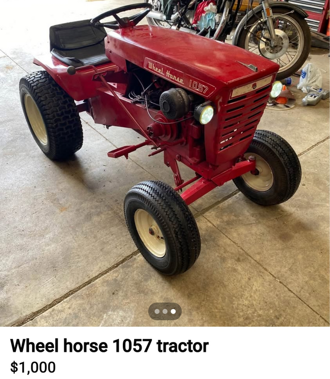

Also a commando 8, single owner, (3 spd), but $900 😮.

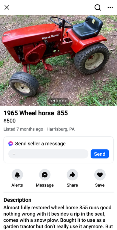

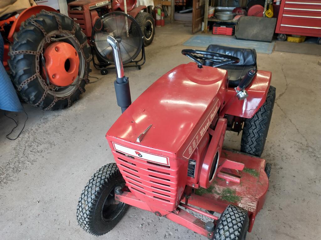

Then there's the 857, below, that probably needs a trans.
I did reach out about the B-80, just to see what I'm told about the 3 listings.
adsm08
That 855 is def worth a look. The 857 as well, because even if the trans is shot it's not hard to swap in a 6-speed.
I do love me an 855.
The 855 and 857 will, mechanically, be pretty much identical units, just different model years. They are 3-speeds, but they are great tractors and I absolutely love mine, when I'm not waiting for parts for it. That is the biggest downside, is that when something breaks, and let's be honest, they are 60 years old, so its when, not if, something breaks nobody local has parts. They usually have to be ordered in, and it takes a few days.
Edited by adsm08
  • Like 2
  • Thanks 1
Handy Don
1 hour ago, Pete D said:
Slipping out of gear is a symptom of wear from heavy use, poor maintenance, or grinding gears.
If tilling is a goal, I’d opt to replace the three with a six instead of fixing the three. Not that fixing is especially hard, it isn’t, (and many folks here have surprised themselves with transaxle repairs) but you do get the crawling gears. I bought a 6-speed from A-to-Z and he took my three speed in trade against the price--you can always ask.
Edited by Handy Don
  • Excellent 2
HyperPete

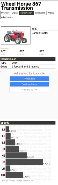

The 857 is 2 hrs away.  The 855 is 40 minutes away.
The 867 comes with a 6-speed, so that should bolt right up. (See, I've been doing my research as fast as possible!)
How much can I expect to pay for a used 867 6-speed in good condition?  Or any other compatible 6-speed.)
kpinnc
867 models were only made one year (1967), and are the only short frame 6 speeds Wheel Horse ever made. That doesn't necessarily make them rare, but 855 and 857 models seem to be more common.
As a result, an 867 may be slightly more expensive than an 855 or 857. But it should be marginally so.

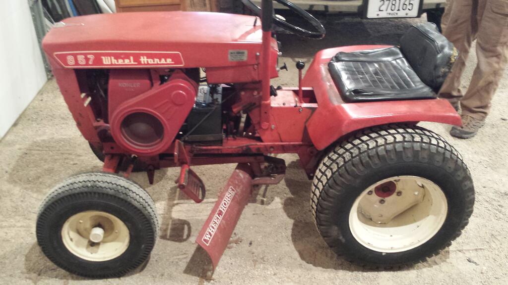

squonk
My 857 I bought from HHHOOOWWWAAARRRDDD!!! in 2018. It's my go to utility tractor for haulin, mowin and plowin. Turns nice and sharp which is nice over the long frame models. I'm 6'1" 240 and I don't look like a circus bear on a tricycle on it. More like a water buffalo in the Serengeti

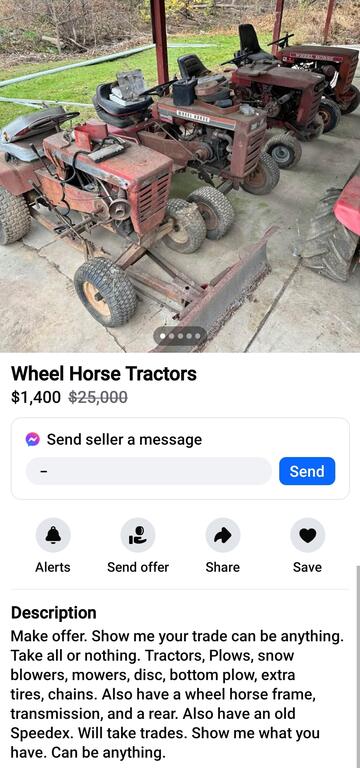

Well, I contacted all three sellers.  The guy with the 857 only said he has several WHs, and they all look not so hot other than the 857.
I guess I can set my radius to 100, instead of 50 miles to see what's out there.
Are there usually a lot at the big show?
Edited by Pete D

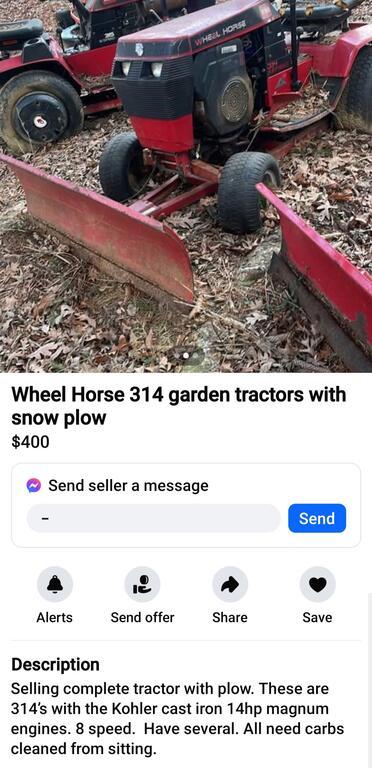

HyperPete
Okl, here's the last bunch of photos, I promise.  It's strange, more "local" tractors showed up too, after the greater radius.
Some are just "interesting" and not something I'm interested in.
Does anyone see anything worth investigating further?
Oh, concerning this one: ( hmmm, photo missing)
1986 Wheel horse  416-8 Kohler
416-8 Kohler 16 horse power. Tractor runs and plows good but starter needs rebuilt. Selling with snow thrower and garden tiller included.
Edited by Pete D
