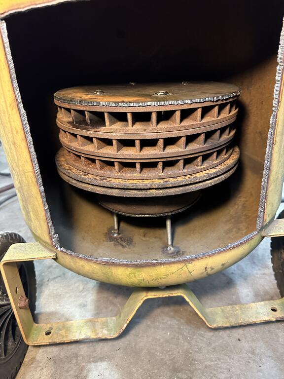

Pullstart 68,521 #51 Posted February 19 To back up a few steps, I did modify the burner a bit. Shortening it up and building a diffuser to spin the air helped. 2 Share this post Link to post Share on other sites
Pullstart 68,521 #52 Posted February 19 This is my burner plate stack. I popped a hole in the top plate and oil drips down from a 3/8” tube into the center of the burner. 5 Share this post Link to post Share on other sites

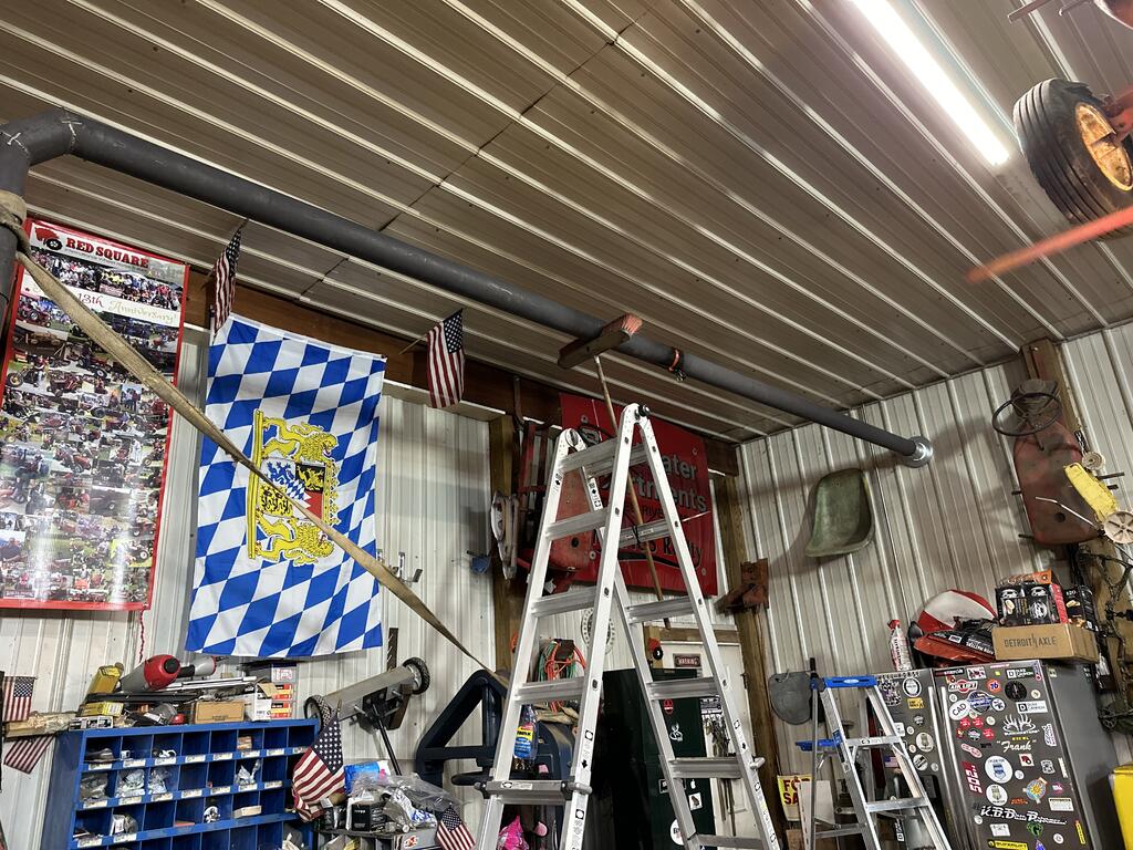

Pullstart 68,521 #54 Posted February 19 15 minutes ago, WHX?? said: Please don't tell me you are going to put a hole in my nice metal roof for a vent! We’re going side wall with a cleanout stack to get above the roof line. I believe code is 2’ above anything within 12’ radius. 4 1 Share this post Link to post Share on other sites

Pullstart 68,521 #64 Posted February 21 My hanger/anchors come tomorrow, then I can set up my radiant heat shields and get my shop broom back. 4 Share this post Link to post Share on other sites
JimSraj 560 #65 Posted February 21 I don’t want to be a wet blanket here but …. Looks like a really loooong run of smoke stack. How high do you need to get you 3’ above in the 12’ radius once you’re through the wall? I’d be concerned about the exhaust gases cooling too much in all that pipe. Share this post Link to post Share on other sites
Pullstart 68,521 #66 Posted February 21 7 hours ago, JimSraj said: I don’t want to be a wet blanket here but …. Looks like a really loooong run of smoke stack. How high do you need to get you 3’ above in the 12’ radius once you’re through the wall? I’d be concerned about the exhaust gases cooling too much in all that pipe. I don’t mind the constructive criticism. I’ve never done this before, so I am no pro. Remember this is fan assisted too. I’ll be keeping a close eye on the heat, making sure it will draft with or without the fire box door open, etc. I think I need to have a 6’+ stack outside. I have plenty of materials, and can change plans if needed. Share this post Link to post Share on other sites
Pullstart 68,521 #67 Posted February 21 Part 3 of the build 2 1 Share this post Link to post Share on other sites
Pullstart 68,521 #68 Posted February 21 Today, I plan to run a test fire inside the shop, then work on an oil delivery system. 2 1 Share this post Link to post Share on other sites
adsm08 3,863 #69 Posted February 21 10 hours ago, Pullstart said: I don’t mind the constructive criticism. I’ve never done this before, so I am no pro. Remember this is fan assisted too. I’ll be keeping a close eye on the heat, making sure it will draft with or without the fire box door open, etc. I think I need to have a 6’+ stack outside. I have plenty of materials, and can change plans if needed. Higher stack makes for a better draft, but you want to keep the horizontal run as short as possible. The gasses will cool as they travel the pipe, but the heat is what keeps them moving, both through expansion and convection. If you loose too much heat in a horizontal run you loose the effect. If you loose the draft best case scenario is that the lack of draft smothers the flame. Worst case, carbon monoxide is heavier than air and settles out into your work space. If you have to have a long horizontal run it's best to do it with double-wall piping and keep it low. If it's at all possible it's best to locate the unit where you can have at most a short horizontal run and a long vertical. I have no experience with fan-assisted exhaust systems. 2 Share this post Link to post Share on other sites
Pullstart 68,521 #70 Posted February 21 I just spent the last hour and a half doing a test fire. It used to be a red tank, then it faded out in the sun to yellowish, then morphed into burnt orange, then just burnt. It was HOT! I learned some things. I added so many wood chunks, it smothered the air make up and did not work well. I needed to boost it a few times with my MAPP torch. I’ll need a bigger combustion fan. When I replace the oil feed with a rubber tipped air nozzle, it really comes alive and the chimney cleans up. The oil preheater tubing I wrapped around the 4” chimney pipe is not necessary. Ambient temperature was about 50 degrees in the shop and it flowed just fine. I managed to make an incredible mess of the shop today. It’s hard to move around and I need to relocate my fire extinguisher, or maybe just pick a few more up. Once this thing gets fine tuned, I will not miss being the wood gopher to keep the shop warmed up! 1 Share this post Link to post Share on other sites
wallfish 18,787 #71 Posted February 22 41 minutes ago, Pullstart said: I’ll need a bigger combustion fan. less holes in the tube? Share this post Link to post Share on other sites

Pullstart 68,521 #74 Posted February 22 14 hours ago, Pullstart said: I’ll need a bigger combustion fan. When I replace the oil feed with a rubber tipped air nozzle, it really comes alive and the chimney cleans up. I ordered a BBQ / forge fan this morning. Be here tomorrow . 3 Share this post Link to post Share on other sites
Pullstart 68,521 #75 Posted February 22 13 hours ago, wallfish said: less holes in the tube? I was thinking maybe more/bigger holes down low. Shortening the tube sure helped. It’s hard to say, but I have drills and a welder. I know how to find out! 1 Share this post Link to post Share on other sites
