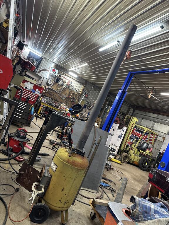

Pullstart 71,135 #29 Posted February 13, 2025 5 hours ago, Pullstart said: Yes, I’ve been recording my thought process and reasoning. I’m fixing for a test fire, before I weld the burner into the tank. To summarize it, it was a lazy failure of fire. I had some stuff to modify and will try again soon. Share this post Link to post Share on other sites
wallfish 20,516 #30 Posted February 13, 2025 47 minutes ago, Pullstart said: To summarize it, it was a lazy failure of fire. I had some stuff to modify and will try again soon. The one I watched had the burner contained with a large tube/pipe which ran through the barrel they used. Could containment of the fuel vapor be the reason for that? Seems logical. There's a bunch of them on youtube so I couldn't find the exact one I watched. Share this post Link to post Share on other sites

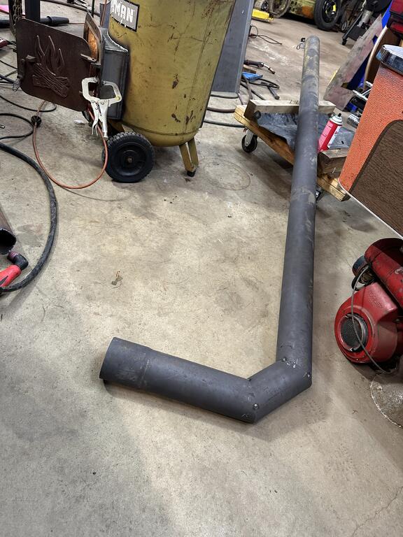

WHX?? 57,845 #32 Posted February 14, 2025 How do you plan on getting rid of the exhaust? Not going to use a gun type burner? Back when things got slow in the HVAC biz I would go to auto shops to try and sell commercial waste oil burners. The few that i sold the customers were happy ... until they broke. Most problems were related to burning oil with water in it. I had a large OTR trucking outfit for customers that I wanted to put them in. They said they didn't have that much since the oil only got changed in 100,000 miles which surprised me. Better off shipping it to a recycler. I take my tractor drain oil to shops in town that have one. Auto parts places won't take it. How do you guys get rid of drain oil? 1 Share this post Link to post Share on other sites
Pullstart 71,135 #33 Posted February 14, 2025 10 minutes ago, WHX?? said: How do you plan on getting rid of the exhaust? Not going to use a gun type burner? I have a few fuel oil burners I thought about playing with, but many people have a fairly simple drip/blower system that works well. I have a complete overhead radiant heat furnace setup. I thought I could hang that tube for about 20’ of the shop, and vent up to that. It’s all 4” heavy wall pipe. I’ll vent out the side wall through a thimble, to prevent any holes in my new steel roof. 4 Share this post Link to post Share on other sites

Pullstart 71,135 #48 Posted February 19, 2025 (edited) It’s been a while since an update. I took the weekend off for family stuff. I did my first actual test fire yesterday and had a couple hours of pure bliss as it lit up and took off! Huge success! Momma gave me some input on shop location. A spot I had not thought of, but makes the most sense. Go figure! Videos coming soon. Edited February 19, 2025 by Pullstart 1 7 Share this post Link to post Share on other sites

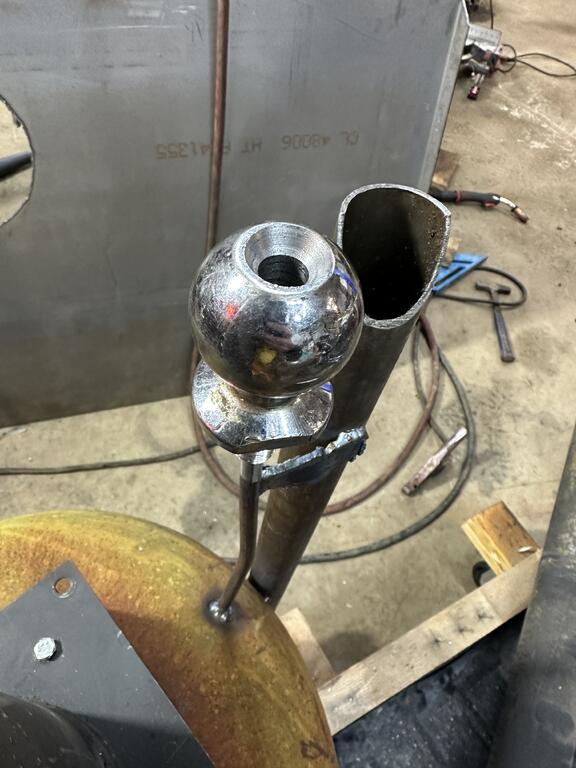

Pullstart 71,135 #49 Posted February 19, 2025 For whatever reason, a lot of people run oil through an open tee. It’s like a cheap sight glass. I decided to make use of one of my 100 1-7/8 hitch balls and make it a funnel with an open drip. 4 1 Share this post Link to post Share on other sites
