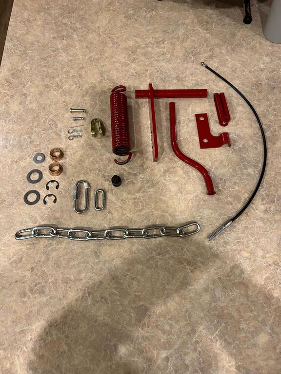

Hey, does anyone have pictures of their tiller hooked up and how all this hardware is supposed to go? Thanks

Refer to the manual for your tiller - I do not see the belt nor idler shown.
Is that the kit from Lowell?? If so, give him a call.....
Racinbob
That kit doesn't come with the tiller. Yes, it's Lowells and the tube is for a hydro tractor. Here's the install for it. It refers to a clevis hitch but it's the same for the rock shaft.

The tiller we bought didn't come with a manual. We have the belt and idler. Last year we hooked it up and it works fine. But it didn't have any of the hydraulic lift setup so I bought this package.
Form No. 810834 Rev B
Thank you. Yes this one is a 520H model. The rock shaft on mine is the new one with two arms instead of one.
