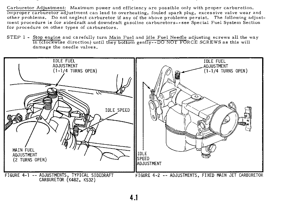

S416-8 396 #12 Posted February 16 Carb cleaned and done, points cleaned, new fuel lines after I got the tank cleaned out, now if I could just dial in the jets so I can get the thing to run again it would be great.. set them the way they were but not liking that now.. Going to have a bit of a parts list to scavenge for this year at the show. Share this post Link to post Share on other sites
pfrederi 19,243 #13 Posted February 16 Do you have the service manual?? Share this post Link to post Share on other sites
S416-8 396 #14 Posted February 16 I do now thanks a ton.. was just digging through the manuals forr one.. Share this post Link to post Share on other sites
S416-8 396 #15 Posted February 17 Thanks again.. got it to start in short burst so now to get a new electronic fuel pump.. Share this post Link to post Share on other sites
RJR49 159 #16 Posted February 17 Not for nothing but I've had great suggest with Chinese carburetors. . Typically cheaper than OEM rebuild kits. 1 1/2 turns. Share this post Link to post Share on other sites
