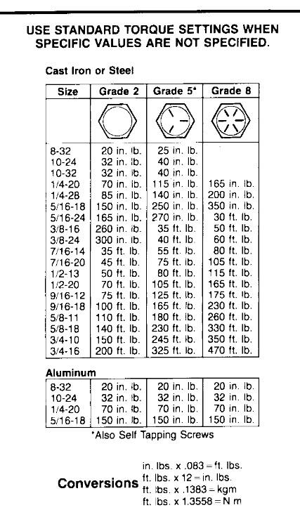

Knight Rider 1 #8 Posted February 11 (edited) I wonder what the torque spec is on the motor mount and transmission mount bolts? Edited February 11 by Knight Rider Share this post Link to post Share on other sites
pfrederi 19,267 #9 Posted February 11 3 hours ago, Knight Rider said: I wonder what the torque spec is on the motor mount and transmission mount bolts? No special torque specified use these 3 1 Share this post Link to post Share on other sites
