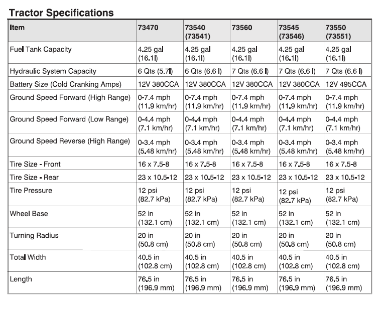

JoeM 7,923 #18 Posted February 10 (edited) yep 4.25 but the manual says to leave a little room in the tank. Another thing I weighed mine with out the deck and it was just short of 1000 by 25 lbs One nicety is the transmission has a neutral and makes it easy to tow! Oil checked ok so just ran it like i stole it figurin it just Pullstart's anyway... Edited February 10 by JoeM 2 Share this post Link to post Share on other sites
RED-Z06 2,478 #19 Posted February 10 1 hour ago, JoeM said: yep 4.25 but the manual says to leave a little room in the tank. Another thing I weighed mine with out the deck and it was just short of 1000 by 25 lbs One nicety is the transmission has a neutral and makes it easy to tow! Oil checked ok so just ran it like i stole it figurin it just Pullstart's anyway... Those tire sizes are kinda disappointing for this market of tractor, id have liked to see an 18x8.50-8 up front and at least a 24x12x12 in back, really makes a tractor sit up Share this post Link to post Share on other sites

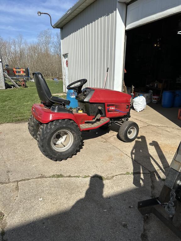

Pullstart 64,463 #20 Posted February 10 54 minutes ago, RED-Z06 said: Those tire sizes are kinda disappointing for this market of tractor, id have liked to see an 18x8.50-8 up front and at least a 24x12x12 in back, really makes a tractor sit up Share this post Link to post Share on other sites
RED-Z06 2,478 #21 Posted February 10 1 hour ago, Pullstart said: Mmm like a glove Share this post Link to post Share on other sites
