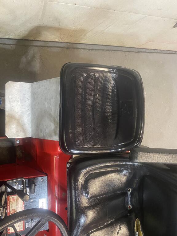

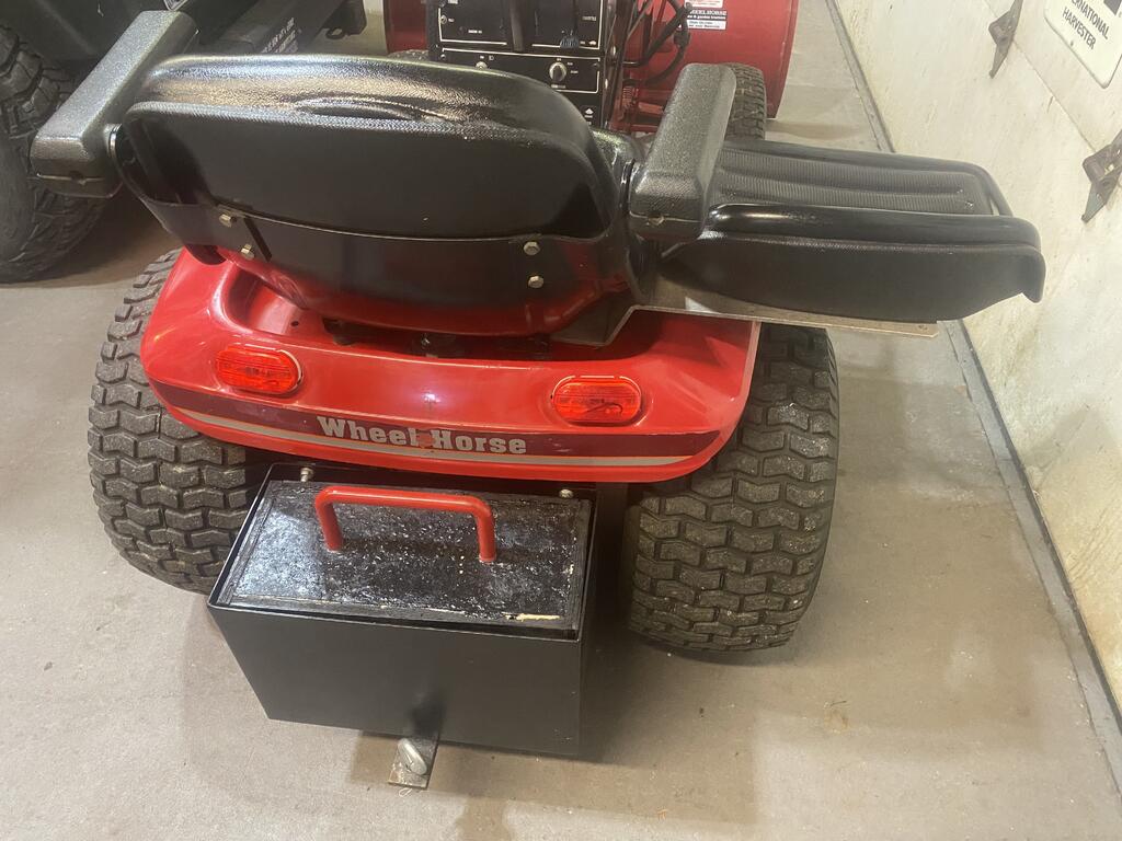

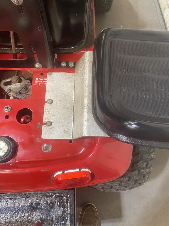

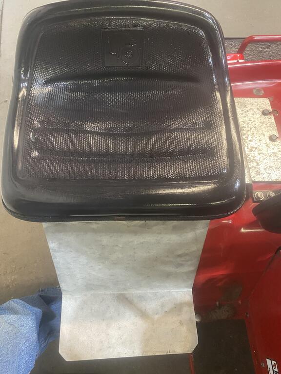

c-series don 9,421 #1 Posted February 9 @SylvanLakeWH Here’s some pictures of my buddy seat that you asked about. As I said in another post it’s actually quite simple. Loosen the bolts on the fender pan, the bracket is slotted so you just slide it in and tighten up the bolts and that’s it! Probably could have taken pictures of the underside, but you get the idea. It’s made out of 1/4” thick aluminum. 3 4 1 Share this post Link to post Share on other sites
