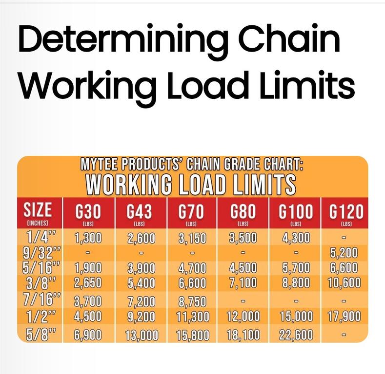

Pullstart 71,144 #6 Posted February 6, 2025 22 hours ago, ri702bill said: Hmmm.... IF you load it by flipping the hitch drawbar up and the have to lever it down onto the ball, there is a potential to have it get away from you , suddeny go vertical due to the weight of the log, & clock you in the face..... Most folks would only do that once..... Some designs, there are some pictured in the search, have a rail that the chain set rides on. You load it all up chained tight with the skidder backed up a ways. When you pull forward, the chain rides up and lifts the log. Now if we could only figure out what size chain would stand up to a Wheel Horse… 1 3 Share this post Link to post Share on other sites
ebinmaine 80,431 #7 Posted February 6, 2025 4 hours ago, Pullstart said: Now if we could only figure out what size chain would stand up to a Wheel Horse… 5/8" G100 should be close... Share this post Link to post Share on other sites
