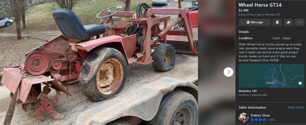

turbofn1 6 #3 Posted February 5 I seen one for I believe $295 but owner stated it was for a gt14 and since being new to wheel horse tractors Im not sure if it would cross over to any of mine and he did not know either, that's some of the help I could use , there seems to be a company a-z with an aftermarket 3 point hitch assembly but I'm having a hard time justify $500 1 Share this post Link to post Share on other sites

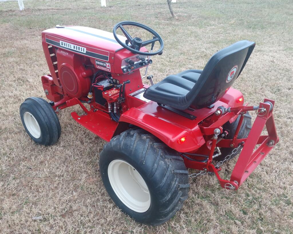

953 nut 57,833 #17 Posted February 10 @kpinnc has a nice three point on a smaller and may be able to hook you up with information on it. As @gwest_ca mentioned the 23" tall tires would be a limiting factor on adding a three point hitch. I built one for a 953 that is quite simple and more for show than it is for work. Jay @JPWH also built one that is more heavy duty that you may want to look at. Share this post Link to post Share on other sites

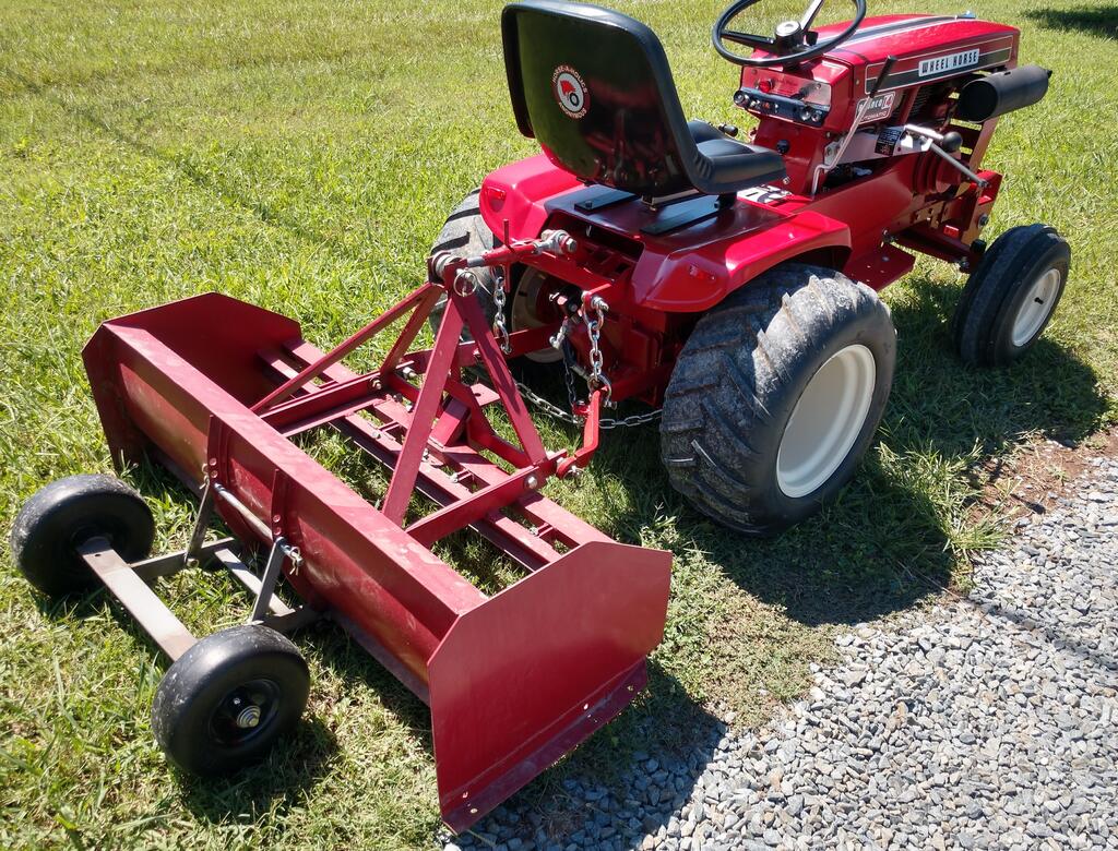

kpinnc 13,703 #19 Posted February 11 13 hours ago, 953 nut said: @kpinnc has a nice three point on a smaller and may be able to hook you up with information on it A 3 point on a small tractor is nice, but you can very easily exceed what the tractor can do with a CAT-0 implement. Don't get me wrong, a Wheel Horse is a stout machine. My grandpa would describe it as "willing mind, but not enough behind" situation. You can design in some help with your lift to raise the back of any implement higher so you clear the ground. I just made my top link roll forward as the implement is lifted for that reason. Of course any hitch add involves alot of fabrication. Mine basically adapts a D series hitch to my Bronco. It works well, but it's alot of modification. 1 3 1 Share this post Link to post Share on other sites
