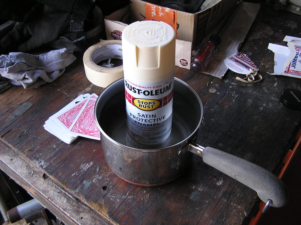

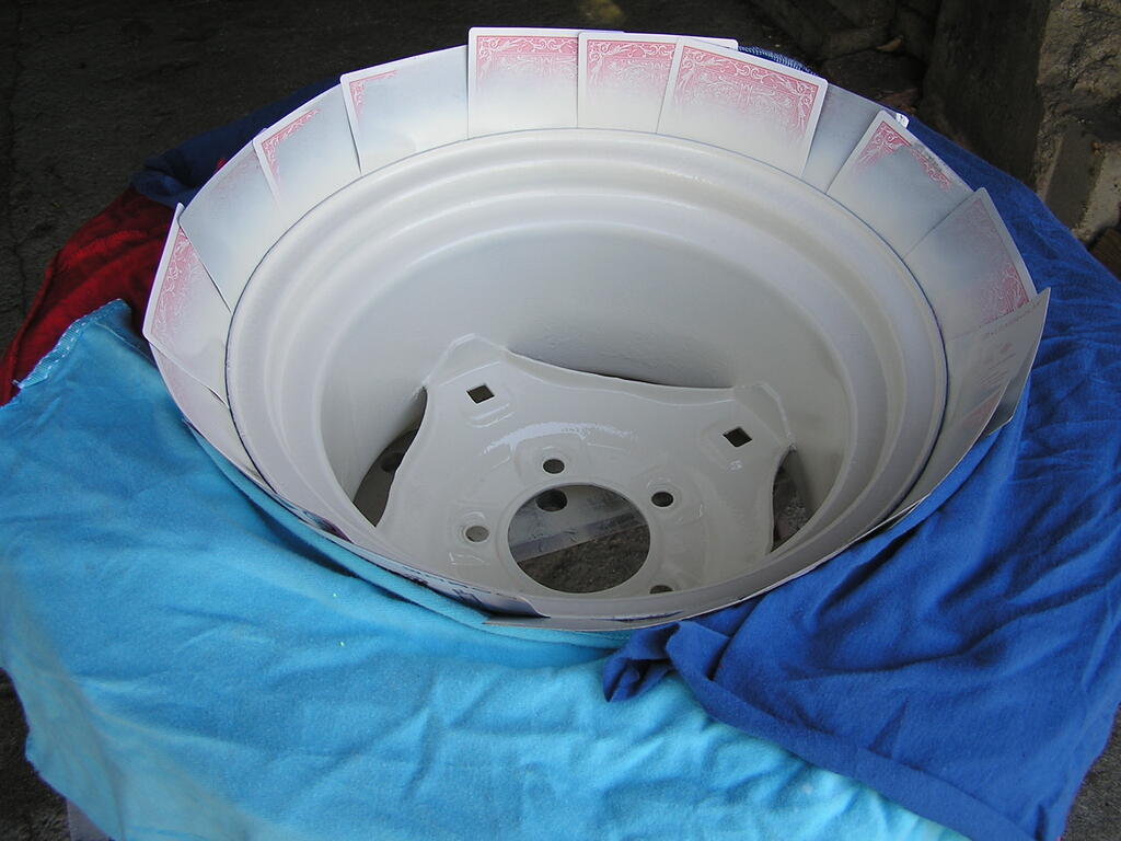

ri702bill 8,939 #29 Posted February 3 DO use the same brand primer & topcoat paints to avoid any compatibliity issues..... Easy way to paint the wheels with the tires on - use playing cards tucked into the deflated bead... and warm the areosol can in hot water between coats... 4 Share this post Link to post Share on other sites
