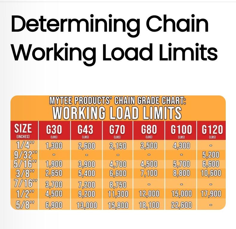

ebinmaine 75,743 #52 Posted January 30 16 minutes ago, Alrashid2 said: Thanks all. I guess I wasn't sure after you @ebinmaine had said to buy a cheaper shackle hitch mount. So are those, even when cheap, rated much higher than we'd need? Lemme look up some specs so I can get an accurate answer. It's important to remember the EXTREME difference in pull capabilities between an inexpensive shackle with a 1/2" or 5/8" pin versus an inexpensive chain with say like a 3/16" or 1/4" wire diameter. Share this post Link to post Share on other sites
ebinmaine 75,743 #53 Posted January 30 41 minutes ago, Alrashid2 said: Thanks all. I guess I wasn't sure after you @ebinmaine had said to buy a cheaper shackle hitch mount. So are those, even when cheap, rated much higher than we'd need? Here's some information that will be helpful for you to understand the difference between Grade 30 and grade 70. "The working load limit of a chain is significantly less than the weight that would cause a chain to fail (the tensile strength of a chain)." Let's consider the lightest duty one just for kicks... 1/4".. Grade 70 has nearly THREE TIMES the load limit of grade 30. As far as buying new versus used, I wouldn't buy new. But it's important to remember I know how to inspect a used chain. I also know where all my chains came from and they had been professionally inspected not long before I got them. If the inspections to ensure good product weren't available to me, I would absolutely buy new. 2 1 Share this post Link to post Share on other sites

Alrashid2 429 #56 Posted January 31 Thanks guys! I did end up going up a grade to Grade 43 5/16 chain. Will post photos later of the rig and hopefully post a video in a week or two when I actually give skidding a shot! @RED-Z06 that is a great idea, we used to throw a blanket over our straps when off roading just in case. Totally forgot about that. Share this post Link to post Share on other sites

bassJAM 93 #64 Posted February 4 17 hours ago, Handy Don said: On a steady pull. Jerking is a different story. Totally disagree unless you add a literal ton of fixed mass to the wheel horse, manage to hit the full speed the GT is capable of before the slack is taken up out of the chain, the log is large enough that it doesn't budge a fraction of an inch, and the chain doesn't slip. OP is using a grade 43 chain with a working load of 3,900 lbs. Normally the working load is about 1/3-1/4 of the tensile strength, meaning the chain shouldn't break until 11,700 lbs of force are applied. As always, check your chains for wear and tear. 2 Share this post Link to post Share on other sites

ebinmaine 75,743 #75 Posted February 4 16 minutes ago, Ed Kennell said: The 3/8" chain should break at 6600 lbs If that's a Grade 70 chain it will have a WLL / Working Load Limit of 6,600 lb. The margin of safety is usually four times. I've seen three. That means your change should be able to withstand something more in the neighborhood of nearly 20,000 lb pull before it snaps. 2 Share this post Link to post Share on other sites
