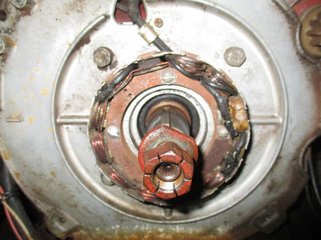

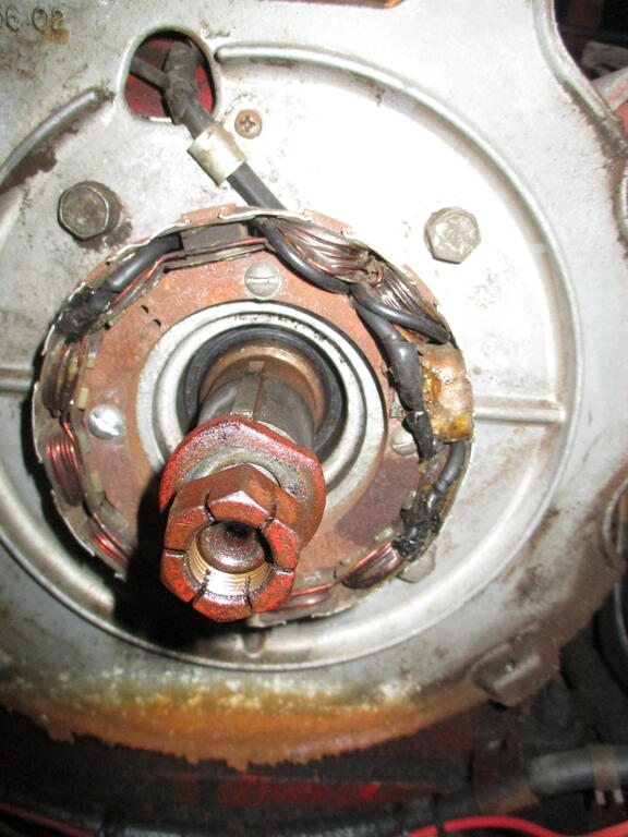

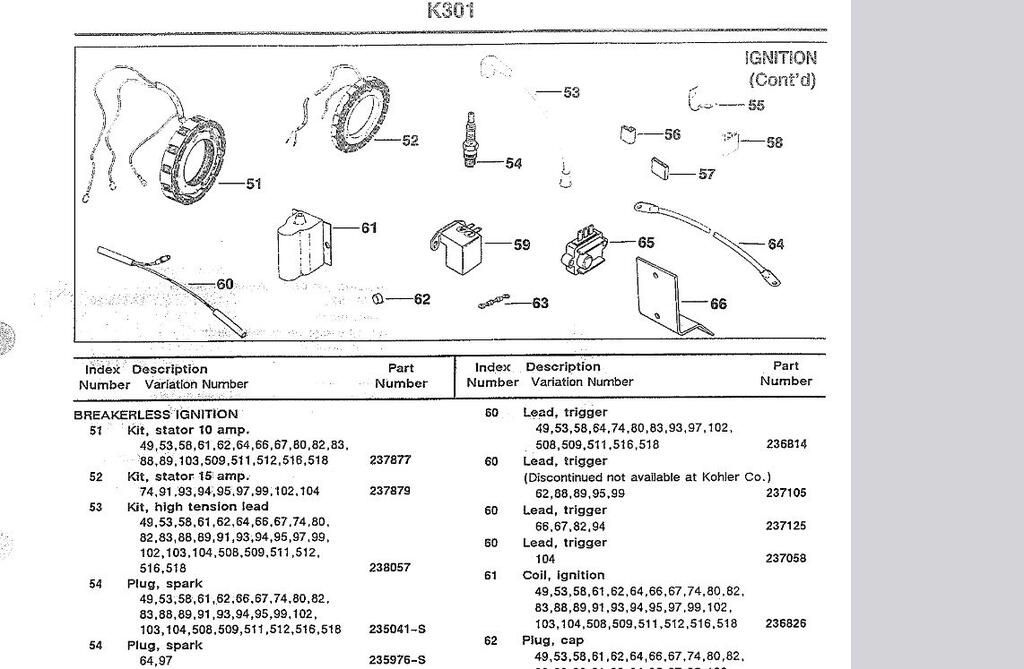

Kenneth R Cluley 582 #1 Posted January 27 I have a 1969 Charger 12. The trigger was bad so I converted it to battery ignition several years ago. Now having charging issue. I had not used for a few months and when i was attempting to start something shorted out on steering shaft behind console. It was the B+ rectifier wire. Replaced all damaged wiring and got running but not charging. Used a couple days on driveway repair by charging battery at night. A C output on rectifier is just over 20 volts @ high RPM. Stator shows continuity and proper resistance 0.1 / 0..2 ohms but not enough voltage to charge battery. My stator is still the old magneto style that goes under flywheel. I believe it has coils on stator for spark. I believe this is a 10 amp stator? Its a K301 model 8 ser#DO44400, spec #17147C. I am trying to figure out how to replace the stator as I believe it is bad. My question is do I use the #237877 10 amp as original and just not use the coil output? I believe I would have to change the flywheel in order to use any other stator. The size is smaller and the magnet assembly fits inside the flywheel, actually one piece fastened to inside of flywheel. Seeking advice/confirmation on the correct repair/replacement. Share this post Link to post Share on other sites

Kenneth R Cluley 582 #5 Posted January 27 (edited) The number could be a 4. lots of paint and a ding in that area. It is definitely the item 51 in diagram. I checked voltage with 3 different meters. seems odd to me that it is showing this voltage reading, and yes it was disconnected. i changed the voltage regulator and still no difference. It is definitely the output of stator. Thought i might find a magnet missing or damaged but all in place. Starts out around 10 volts at idle and increases to just over 20 at 3600 RPM. Looked at wiring for possible bad spot or corroded connections but all looks good Could I even find a #237877 stator? Definitely a 4 just went out and checked. I was moving it out of storage and turned the steering wheels several times, then when i turned on switch to try to start the smoke started rolling out from behind dash. I am upset at myself for being "sloppy" with wiring in that area. The rectifier B+ was laying on top of steering shaft and rotation wore through insulation. Could have prevented with a .03 cent wire tie. Edited January 27 by Kenneth R Cluley Share this post Link to post Share on other sites
Kenneth R Cluley 582 #6 Posted January 27 So I guess my question for you all is can i just replace this stator with a 15/20 amp such as #237878 without changing flywheel? I realize I must match regulator to stator. Or must I also change all components to use the 15/20 AMP stator? Share this post Link to post Share on other sites

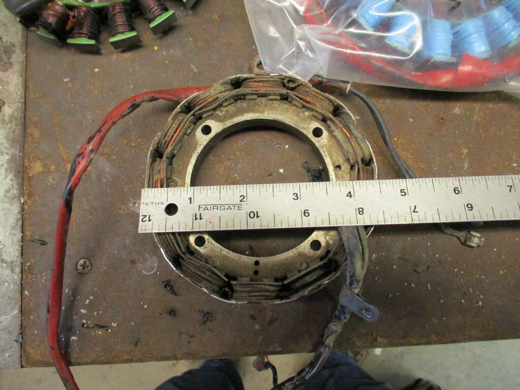

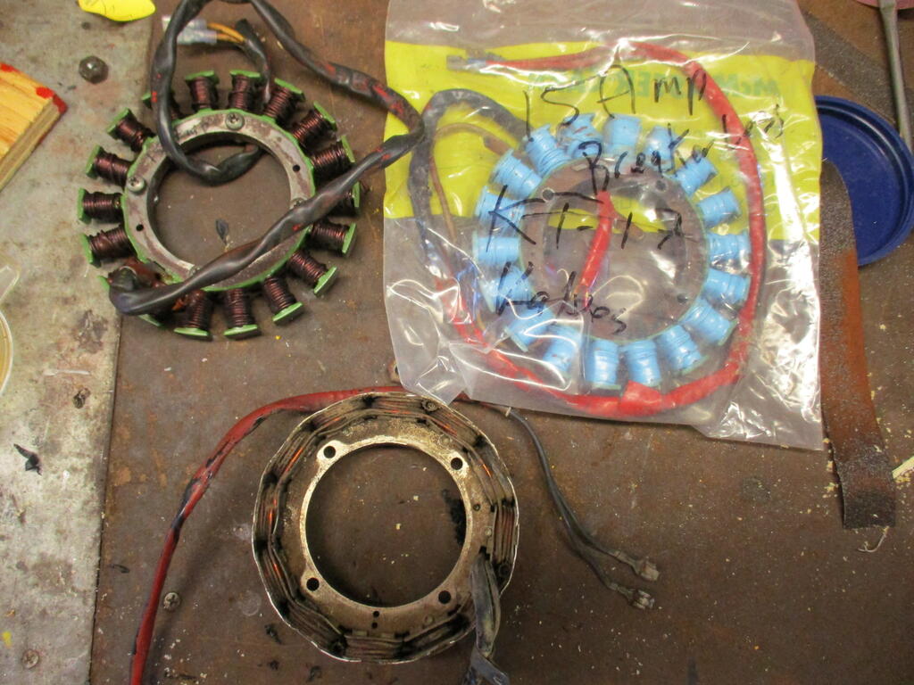

pfrederi 18,322 #7 Posted January 27 I do not think so. The Flywheel part number for the 10 amp breakerless is different tat 15 amp system. The 15 amp stator is bigger diameter You can see the difference one in front is from a 10 amp breakerless 15 amp regular and breakerless in the back. I do not have a 10 amp regular stator to compare 2 Share this post Link to post Share on other sites
Kenneth R Cluley 582 #8 Posted January 27 I guess that was my gut feeling. Thanks for all your help, now the decision as to which direction to go for repair. Common sense telling me to go with 15 AMP conversion. I guess I'll let it simmer a while and maybe it will come to me. Share this post Link to post Share on other sites

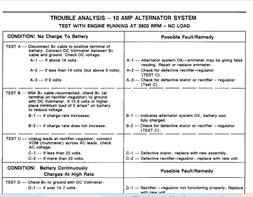

pfrederi 18,322 #10 Posted January 27 I have a 10 amp stator for a battey ignition. Looks to be new. Don't remember how or why I got it. Reads about .6 ohms across the leads and no short from either lead to ground. The .6 is higher than the 15 amp spec...but Kohler doesn't show a 10 amp resistance spec.... also the Kohler manual say for 10 amp stator 20 Volts AC and up is ok.... Another note part numbers for a stator can vary based just on the length of the leads and type connector.... Share this post Link to post Share on other sites

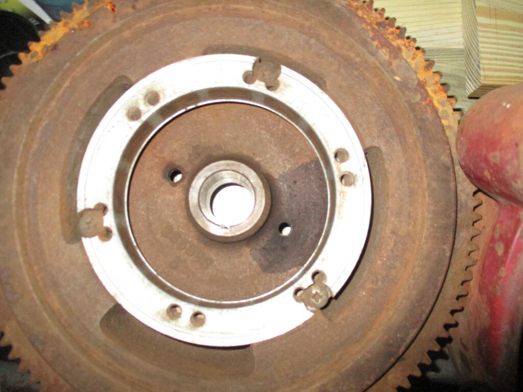

Kenneth R Cluley 582 #11 Posted January 27 I guess i was looking at the 15/20 troubleshooting chart. I think i will tear into wire connections at stator like Don said just to be sure, what have i got to lose? Thanks for all the help, was just looking at available flywheels for K301 to make 15/20 stator work. Can't find numbers for most items, even Kohler engine site has no listings for stators or flywheels. Don't understand how 20 volts a/c will give you enough when converted to DC. Half wave only @10 volts? I am not electrical engineer or anything but pretty familiar with rectifier circuits. Share this post Link to post Share on other sites
