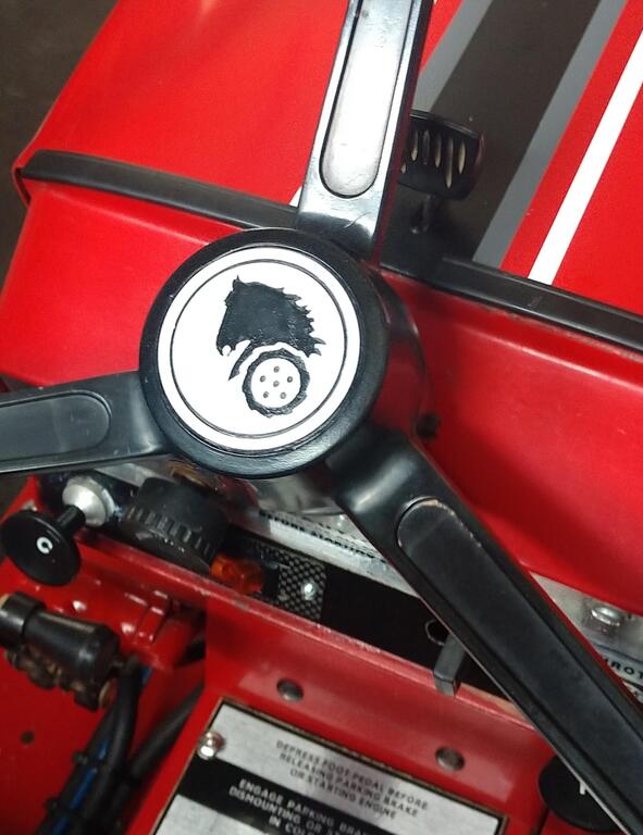

pfrederi 19,268 #1 Posted January 25 Is there a way to remove the cap with out destroying it? This is about my only horse that still has a cap. Got the roll pin out but need to get cap off. 1 Share this post Link to post Share on other sites
kpinnc 16,192 #3 Posted January 25 The plastic used on those is very thin. I've never been able to remove it without breaking. But WheelHorse 3D makes a nice replacement... 1 Share this post Link to post Share on other sites
ebinmaine 75,752 #4 Posted January 25 I've seen a wheel that shape that didn't have a removable cap. Solid top. Share this post Link to post Share on other sites
pfrederi 19,268 #5 Posted January 25 I think the cap is going...besides no cap makes it easier to squirt a little lube on it once and awhile ...makes removal in the future easier... 1 Share this post Link to post Share on other sites
pfrederi 19,268 #6 Posted January 25 Got the cap off drilled a couple holes and pried... but there was solid plastic under it down to the start of the steering shaft ...over an inch of plastic.... 2 Share this post Link to post Share on other sites
oliver2-44 11,062 #8 Posted January 26 That is a big victory! Share this post Link to post Share on other sites
Lee1977 7,456 #9 Posted January 29 (edited) On 1/25/2025 at 2:46 PM, ebinmaine said: I've seen a wheel that shape that didn't have a removable cap. Solid top. I don't think the one on my 1985 312 is removable, don't see a seam, looks solid to me. Edited January 29 by Lee1977 1 Share this post Link to post Share on other sites
RED-Z06 2,690 #10 Posted January 29 To my knowledge once the roll pin is out there isnt anything under the steering wheel to retain it. 2 Share this post Link to post Share on other sites
pfrederi 19,268 #11 Posted January 29 18 hours ago, RED-Z06 said: To my knowledge once the roll pin is out there isnt anything under the steering wheel to retain it. True except for 40 years of corrosion and to use a puller have to access the end of the shaft 1 Share this post Link to post Share on other sites
