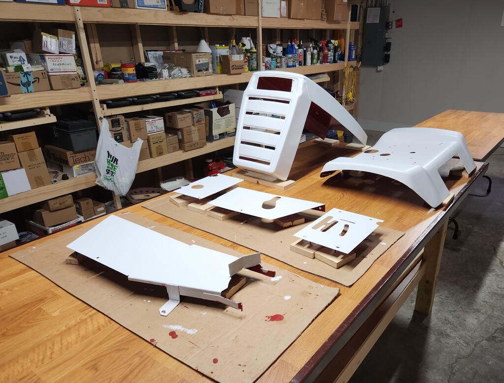

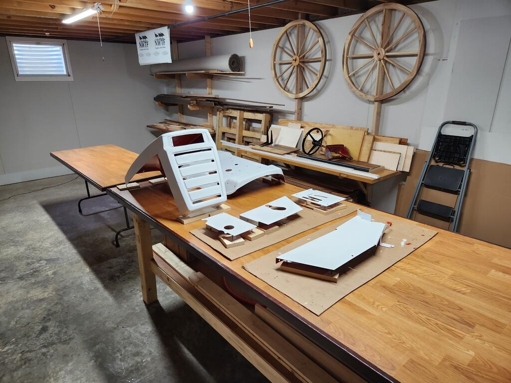

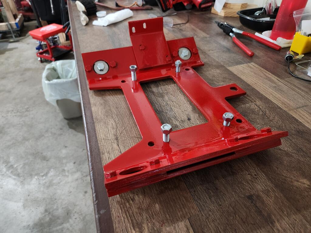

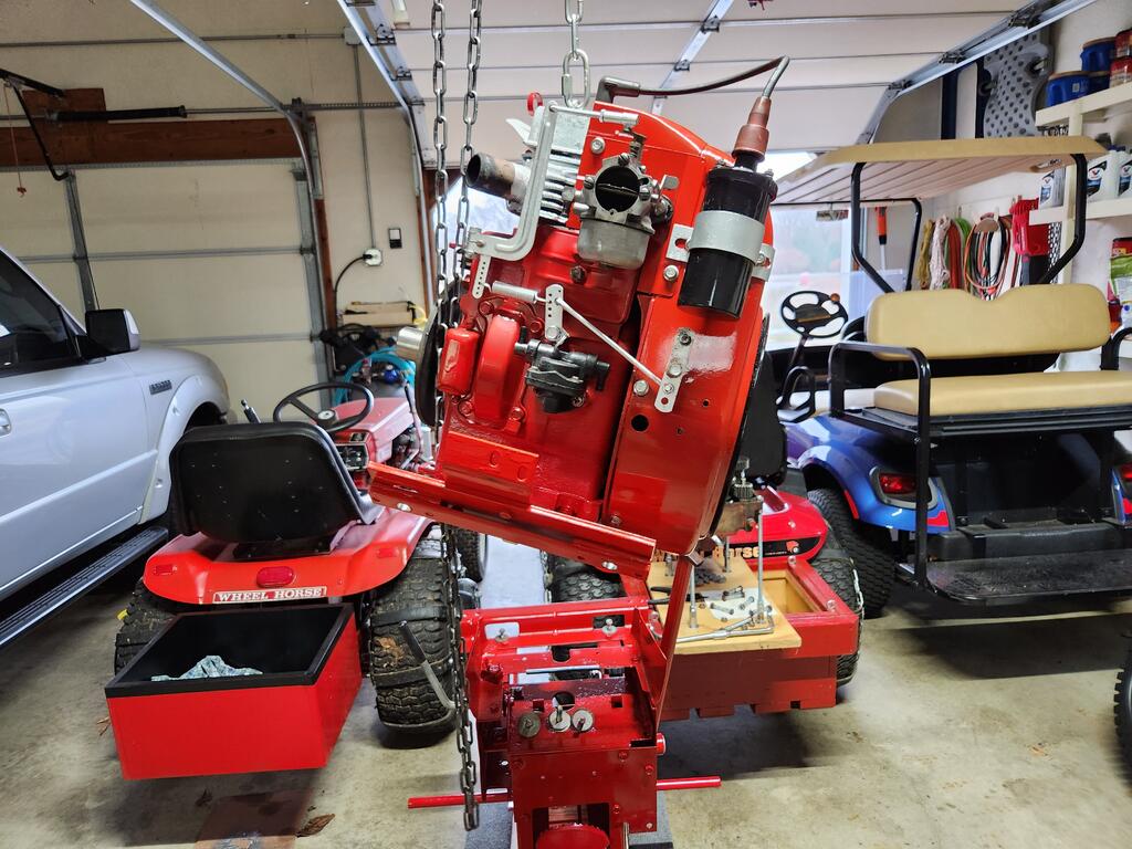

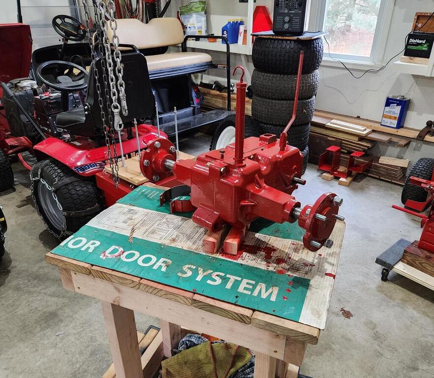

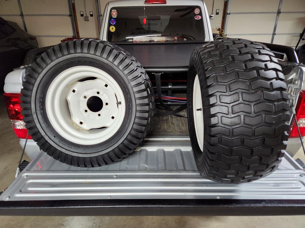

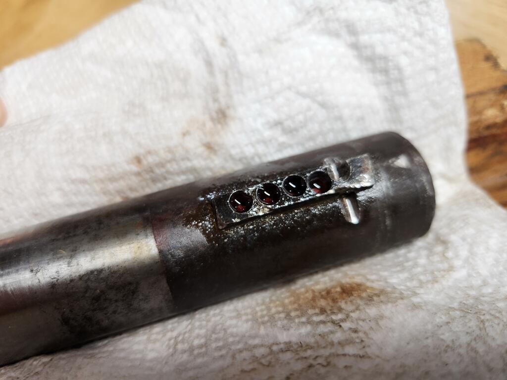

Racinbob 11,702 #1 Posted January 22 Progress is limited due to the weather. We've had sub zero lows. The nice 23-10.50's will get a coat of the mixed 'beige' when we get a warm enough day. The wobbles have been eliminated on the engine base. I ran into an oil drain clearance issue involving the steering shaft steering shaft that I'll have to address. I found a local shop with a press and finally got the hub off. But then the problem was the key. I tried every trick in the book and it never budged. I gave up and found a replacement axle. At least the hub was saved. Put the transmission back together and ready to mount. The major tins are primed and ready for Rusty Regal come spring. The hood had a pretty big dent but I did get it out fairly good. Not perfect but from 100 yards it looks fine. The insides of the tins are painted read with a blended paint to match the Regal. 2 12 2 Share this post Link to post Share on other sites
Ed Kennell 40,384 #2 Posted January 22 1 hour ago, Racinbob said: The wobbles have been eliminated on the engine base. I ran into an oil drain clearance issue involving the steering shaft steering shaft that I'll have to address. I had the same problem when I used the modified shaker plate as an engine base plate in my low rider. I moved the drain off center to clear the shaft. 1 hour ago, Racinbob said: I tried every trick in the book and it never budged Weld a flat bar to the key and attack with the BFH. The heat from the welding has loosened broken bolts and saved having to drill them out. 4 1 Share this post Link to post Share on other sites
Racinbob 11,702 #3 Posted January 22 37 minutes ago, Ed Kennell said: Weld a flat bar to the key and attack with the BFH. The heat from the welding has loosened broken bolts and saved having to drill them out. Ok, every trick but that one. I've got a new welder on its way. I'm thinking my first little project....... 3 Share this post Link to post Share on other sites

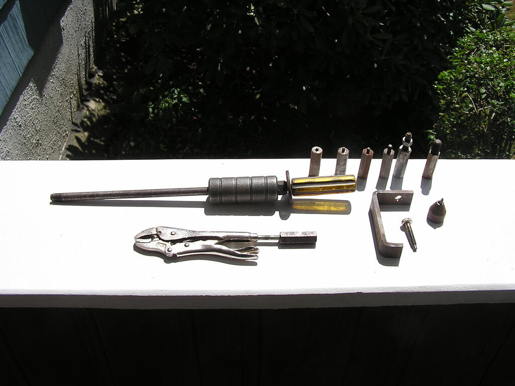

ri702bill 8,936 #4 Posted January 22 My Vise Grip adapted to the front of an autobody slide hammer has yet to fail me in key removal - other adapters are for pull dowels. Had this 40 years... 3 Share this post Link to post Share on other sites

Racinbob 11,702 #6 Posted January 22 2 hours ago, ri702bill said: My Vise Grip adapted to the front of an autobody slide hammer has yet to fail me in key removal - other adapters are for pull dowels. Had this 40 years... Tried but it didn't even give a hint that it would budge. 1 Share this post Link to post Share on other sites
stevasaurus 23,045 #7 Posted January 22 I think a 4" grinder making a slot down the middle of the key would get her done. Then you can tap what is stil showing with a punch or old chisel. BTW Bob, you have way too much shelf space !! Looks great !! 6 Share this post Link to post Share on other sites
Racinbob 11,702 #8 Posted January 22 14 minutes ago, stevasaurus said: I think a 4" grinder making a slot down the middle of the key would get her done. Then you can tap what is stil showing with a punch or old chisel. BTW Bob, you have way too much shelf space !! Looks great !! Not a die grinder but it still wouldn't budge. I'll keep trying and if I happen to get it out the axle will be just fine for somebody. 2 1 Share this post Link to post Share on other sites
953 nut 57,740 #9 Posted January 23 12 hours ago, stevasaurus said: slot down the middle of the key would get her done. Then you can tap what is stil showing with a punch or old chisel. Use a cut-off wheel in a die grinder to cut all the way through the key then attack it from the side with a chisel. 1 1 2 Share this post Link to post Share on other sites
squonk 42,444 #10 Posted January 23 Dremel and about 25 of those tiny cut off wheels. Slot it lengthwise. 1 2 Share this post Link to post Share on other sites
