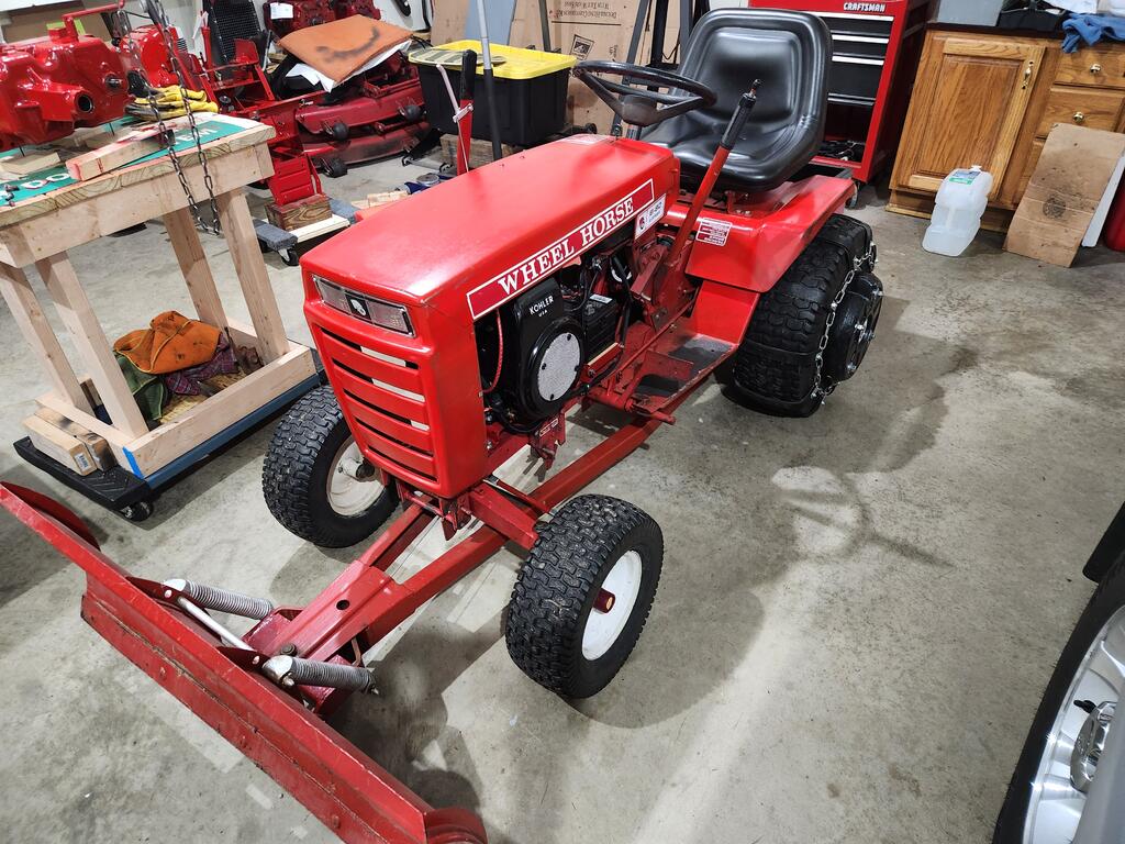

Hey guys, curious if any of you are in similar circumstances or have dealt with this before and appreciate your advice!
I'll try to keep it short. I've got my 312-8 outfitted with a nice 42" plow. Our driveway is 125 ft long, and is steep - 15% grade! Despite this, I have had no problem this year plowing, even uphill, with normal turf-saver tires and some 50 lb wheel weights on either rear tire. No slipping, didn't have any problems moving snow.
I park my Horse down in a shed, about 50 yards from the driveway, downhill, same steepness as the driveway (whole properly slopes). When trying to pull the tractor up to the house yesterday, I kept getting stuck... would be chugging along and eventually start spinning out. I eventually got it up but it took a lot of trial and effort, and ripping up the ground...
No big deal for plowing here and there, but I bought this tractor to haul firewood up to the house every couple of weeks. With the snow not melting anytime soon, I'm worried on how I'll be able to bring firewood up... if I was spinning out before, it'll surely be worst pulling a 300 lb cart of wood uphill...
The ground under the snow is forest floor: dirt, oftentimes muddy if not frozen, and a thick layer of dead mushy leaves.
Any advice on how to get up this? I'm going to try and get a good start (I don't start spinning out until I'm nearly at the house) and I'm hoping some momentum will push me through. Maybe the snow/ground will freeze/thaw a bit in the next few days and I'll be OK. But figured I'd ask you guys if you have any advice. Would it be better to go faster and use momentum to push through? Or should I go slow and steady in low gear? Not interested in studs or chains so just wanted to see if you guys had any technique advice for me. Thanks all!

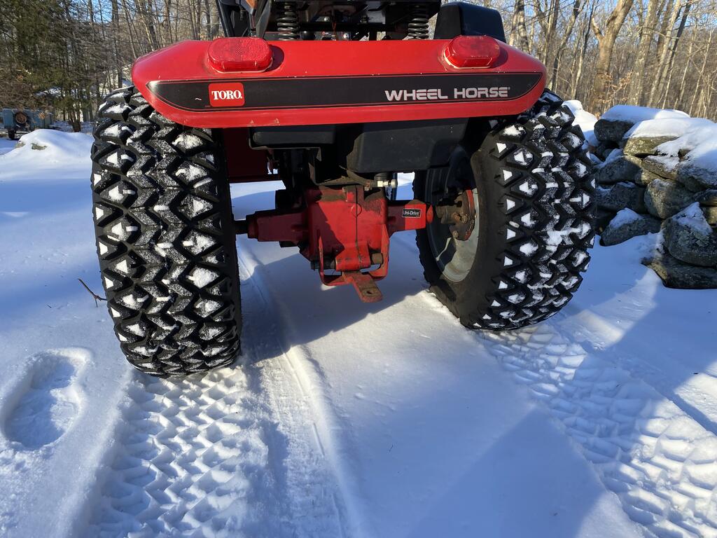

OutdoorEnvy
10 minutes ago, Pullstart said:
Skinny tires help too.  Less contact patch and more weight equals more contact PSI.  That’s what it’s really all about.
This option seems to get overlooked.  In this pic the tires are 6-12 size and they aren't an AG but the tread is deeper then it looks.  These get around awesome in my woods and do pretty well plowing too.  I like the tighter line it holds and seems to cut through soft dirt better.  I think a pair of 6-12 AG tires would be awesome.  They are on my list at some point.  But they usually are cheaper but do need the narrow rim to work.
Now I do have two sets of Carisle AG tires in 23x10.5-12 and they are good too.  I haven't weighted them down yet but would be an interesting comparison with the 6-12 weighted down too.
