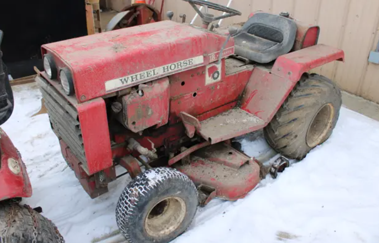

Testing kit in tomorrow so will see what it shows and update the thread. Then I just ended up picking up a barn find D180 and pick it up tomorrow. Now to find some D180 accessories.
S416-8
Got a new toy !! Now to find a 3-point hitch and a plow
Edited by S416-8

for the 180 I hope that I can find the 3-point hitch for it. if anyone has one for sale let me know..
