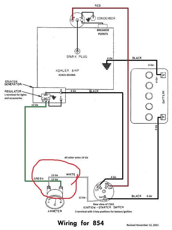

squonk 44,859 #9 Posted January 20 702 came from the factory with an ammeter. Has it been changed to a voltmeter. If it's still an ammeter and in the circuit it could be your issue 2 Share this post Link to post Share on other sites
702854boy 382 #10 Posted January 20 Yes it was converted to a volt meter, we did that last year when we redid the wiring. We do still have the factory ammeter but, it is on our 854 because I thought it looked coller than the sw ammeter that it had. Do any of you know of a wiring diagram that includes a volt meter instead of the ammeter? 1 Share this post Link to post Share on other sites
