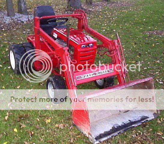

It has been done on occasion. Eldon did it with the C520 mod many years (2007?) ago. Of course this tractor had a modified hood, and it looks to be slightly raised in the front. The exhaust was not modified, which is the only reason I mentioned it. Basically a 500 series with C series sheet metal. Of course the hood was half and half welded up to fit the 500 center console to a C series nose. Clearly sat higher front and rear so far as the hood goes.
Very few pics of this thing out there, as the photobucket account it was on previously seems to be gone.
But I've driven this monster back in the day, and the exhaust was stock.
