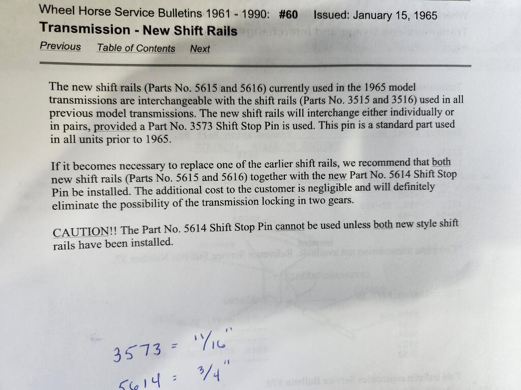

Racinbob 13,117 #8 Posted January 17, 2025 You are correct in that your transmission is a 5025. Since you're going to have it open you may want to do the shift rail and stop pin upgrade per service bulletin #60. The flats as already mentioned help with the shifter issue but isn't a positive stop. The upgraded rails not only have the flat but a deeper neutral detent. Used with a longer stop pin it's a mechanical stop and doesn't allow the shifter to lock up in two gears. 4 Share this post Link to post Share on other sites
