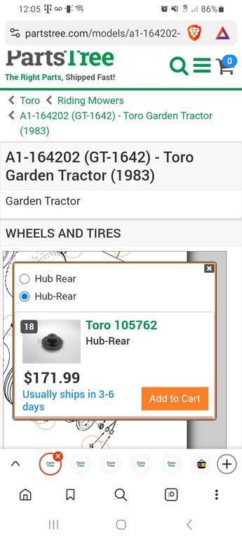

Horsin'round 482 #6 Posted January 15, 2025 Partstree lists 2, not sure of the difference. https://www.partstree.com/models/a1-164202-gt-1642-toro-garden-tractor-1983/wheels-and-tires-22/ 2 Share this post Link to post Share on other sites

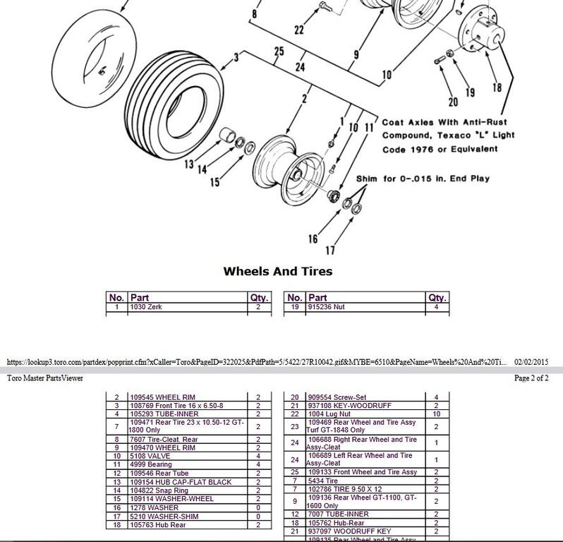

pfrederi 21,103 #8 Posted January 15, 2025 Unless I am really missing something here it uses 1-1/8 hubs part #105763 1 Share this post Link to post Share on other sites
mowerman1193 42 #9 Posted January 15, 2025 The problem is the manual shows hubs for both the GT-1600 / 1642 and also the hydro model GT-1800 / 1842 and I believe I have the 1" hub and the hydro has a 1-1/8 hub.. but they don't show what part number is what size hub.. I did see A-Z on eBay that sold the tape lock two piece hub in case my axle is damaged. Share this post Link to post Share on other sites

mowerman1193 42 #13 Posted January 15, 2025 13 minutes ago, pfrederi said: Unless I am really missing something here it uses 1-1/8 hubs part #105763 If you look at the parts list you posted there are two number 18's in the parts list.. one is on the left side of the list and the other is in the right side.. one showing #105763 and the other is #105762 I assume one is for 1" axles and the other is 1-1/8.. but what number is for the 1" and what number for the 1-1/8? This is one of the issues I have with these manuals and parts viewers.. I can measure my axle to verify the size but it is the 8 speed trans not the Eaton hydro. Share this post Link to post Share on other sites

pfrederi 21,103 #15 Posted January 15, 2025 (edited) 105763 is 1-1/8 105762 1" Edited January 15, 2025 by pfrederi 2 Share this post Link to post Share on other sites

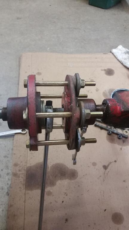

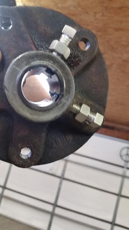

mowerman1193 42 #19 Posted January 15, 2025 Well I was able to get the hub off finally and it is definitely chewed up in the keyway area and the axle is too but not really bad.. but bad enough I didn't want to chance a new hub so I ordered the repair hub from A-Z.. little concerned about the spot where the second hub securing bolt went in on the axle as the keyway being buggered out allowed the hub to slip on the axle shaft and that second bolt chewed into the axle a bit. I'll have to file it down around the edges of that area. Hopefully this repair kit will hold up. 1 Share this post Link to post Share on other sites

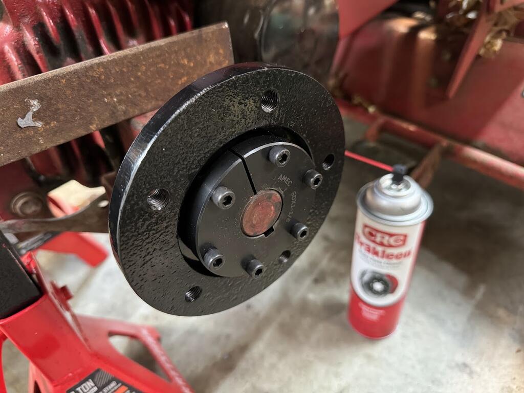

mowerman1193 42 #24 Posted January 22, 2025 Thanks to all that replied on this topic, Got the new two piece hub yesterday and threw it all back together.. I haven't test drove it, but I think it'll be fine. Probably wait to put the wheel weights back on after I make sure it's going to work fine. 2 Share this post Link to post Share on other sites
