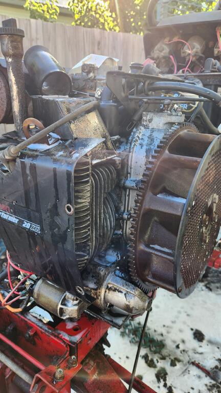

Red Stallion 109 #1 Posted January 15 I thought I would start a dedicated thread where I can put all my questions, and document my restoration journey. And also ask the brain trust for advice and guidance as I go. I posted in another thread, and was quickly advised that because I live in Australia, I should consider the mod to remove the tins and and increase airflow around back cylinder. Are the tins people referring to, the heat shield looking things around the cylinder head? I have pulled off all the panels, and plan to get them blasted and then repaint. Then it needs a good bath and it has a lot of build up of dirty and lawn clippings. 4 Share this post Link to post Share on other sites

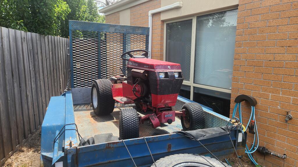

Red Stallion 109 #2 Posted January 15 But this is my starting point! I've had it for about a year, and stripped the carbs, replaced the rubber, and its now starting after a couple of cranks. 3 Share this post Link to post Share on other sites
lynnmor 7,551 #3 Posted January 15 24 minutes ago, Red Stallion said: I thought I would start a dedicated thread where I can put all my questions, and document my restoration journey. And also ask the brain trust for advice and guidance as I go. I posted in another thread, and was quickly advised that because I live in Australia, I should consider the mod to remove the tins and and increase airflow around back cylinder. Are the tins people referring to, the heat shield looking things around the cylinder head? I have pulled off all the panels, and plan to get them blasted and then repaint. Then it needs a good bath and it has a lot of build up of dirty and lawn clippings. That is just the tip of the iceberg, the bulk of the tins are on the opposite side. Don't confuse the engine tins with the belt guard. It is obvious that you have an oil leak issue, find the source and repair that, perhaps it is the crankshaft seal behind the PTO clutch. Share this post Link to post Share on other sites
953 nut 57,706 #4 Posted January 15 36 minutes ago, Red Stallion said: I should consider the mod to remove the tins and and increase airflow around back cylinder. Removing the heat shields around the cylinders is done for cleaning of the cooling fins on the cylinders. The "engine tins" direct airflow from the flywheel fan to both cylinders and the engine should not be run without them in place. 40 minutes ago, Red Stallion said: ask the brain trust Good One, do you have any other jokes you would wish to post. Share this post Link to post Share on other sites

kpinnc 13,622 #7 Posted January 15 1 hour ago, Red Stallion said: when you say tins, is it those heat shield looking things bolted to the head? They look like baffles to direct the airflow coming off the black shroud? The mention of tins refers to the engine covers only I think. None of that needs modification and should all be in place when the engine is running. And yes that includes the baffles on the backside of the cylinders. The oil filter grommet I mentioned on the other thread just seals in the airflow from the flywheel and assists in cooling. Share this post Link to post Share on other sites

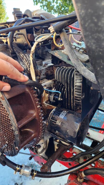

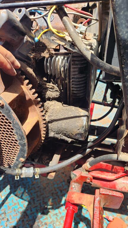

Ed Kennell 40,373 #8 Posted January 15 2 hours ago, Red Stallion said: I thought I would start a dedicated thread A little late, but thank you. Engine tins, shrouds, heat shields, call it what you like. This is the ductwork that directs the cooling air over the engine cooling fins. Unfortunately the flywheel fan also sucks up grass clippings and blows them across the cooling fins where they become stuck if there is any leaking oil on the fins. Remove the ductwork Locate and repair any oil leaks..look closely around the oil filter base plate Clean the fins..do not paint Remove the heads and decarbon the chamber Set the valves Seal the oil filter to the duct work with the grommet or if not available make your own with a peel and stick door insulation. Does venting the belt guard improve air flow across the rear cylinder But it will not restrict it I do not use my 520 or any twin engine tractor for mowing. IMO they are inefficient using excessive fuel that is converted to heat instead of HP. I only use 10 and 12 HP singles for mowing and dedicate the the 520 to winter snow removal. It excels in this duty using all that heat to warm the cab. Just my based on my limited experience. 5 1 Share this post Link to post Share on other sites

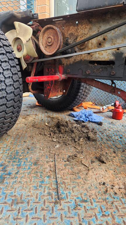

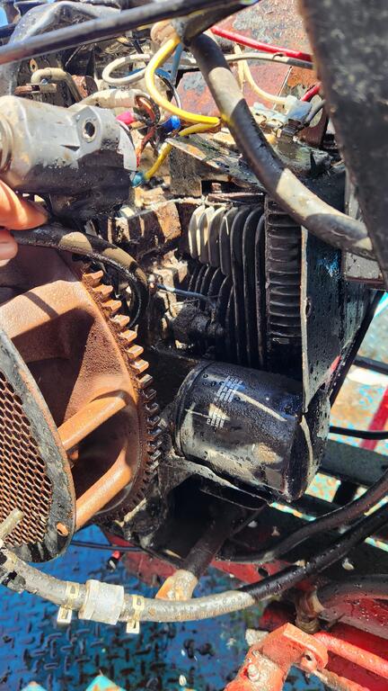

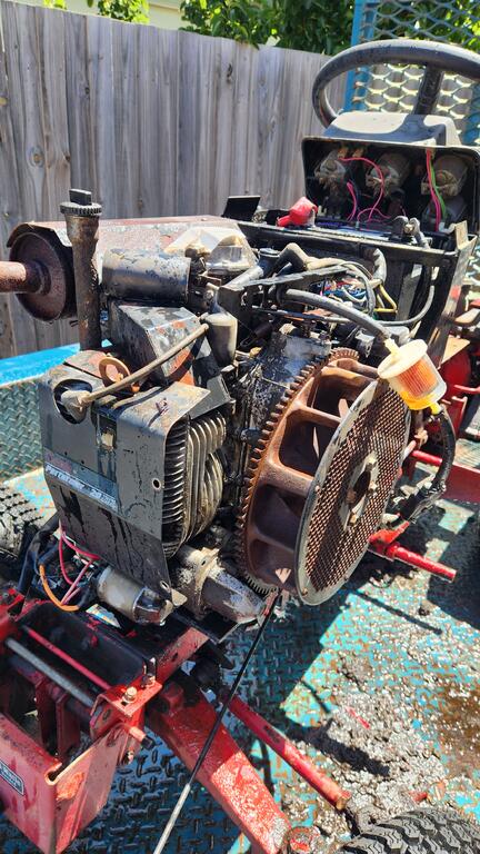

Red Stallion 109 #10 Posted January 16 Slowly working my way through the low hanging fruit. Starting with a bowl full of prunes to clean out a pile of clippings and dirt from around the gear stick/brake mechanism. Now the brakes work, as well as the park brake! Started pulling off my tin, but the bolt under the petrol filter is going to need a ring spanner... one of those pesky non-netric kinds. And I think I get what you mean about the oil filter gasket! The seal around the filter body to the shroud. Not the seal between the filter face and the engine block. Can someone tell me if the oil filter for the engine is the same and the oil filter for the hydro? A complete fluid swap is on the cards soon. 2 Share this post Link to post Share on other sites
kpinnc 13,622 #11 Posted January 17 3 hours ago, Red Stallion said: And I think I get what you mean about the oil filter gasket! The seal around the filter body to the shroud. Not the seal between the filter face and the engine block. Can someone tell me if the oil filter for the engine is the same and the oil filter for the hydro? A complete fluid swap is on the cards soon. Correct on the oil filter seal. No, the filter for the transmission and engine are not the same. The transmission uses a Napa 1410, or equivalent. It's important to note this is a hydraulic filter with no bypass valve. The engine oil filter has several options. It's a good idea to get the longer filter whatever version you buy. It seals better with the grommet for airflow, and is much easier to install and remove. 1 1 Share this post Link to post Share on other sites

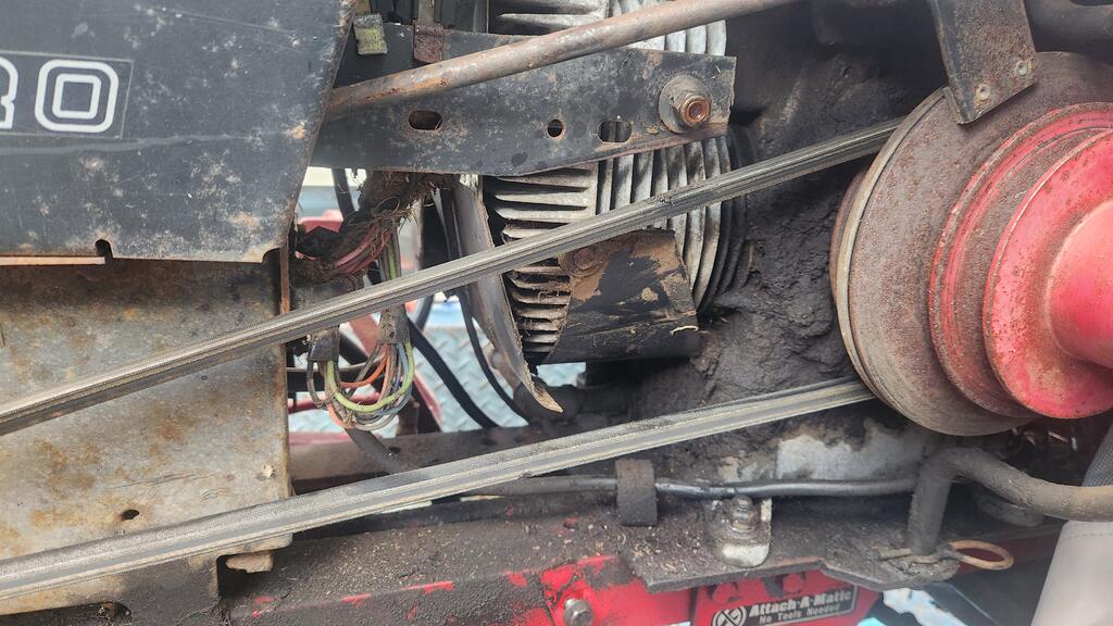

Red Stallion 109 #13 Posted January 17 Finally got the main shroud off, and it was covered it dust, mud, spider eggs, grass, and everything else. Going to give it a liberal bathing over the next few days with lower pressure water. Bit of a risk on the electrics, but there is too much caked on crud to scrap off Share this post Link to post Share on other sites
Ed Kennell 40,373 #14 Posted January 17 3 hours ago, Red Stallion said: filter face and the engine block. Looks like your OK on the oil filter and the need to seal the can to the shroud. The other seal where I have found oil leaks are between the engine block and the base plate that the oil filter screws on to. Share this post Link to post Share on other sites
Ed Kennell 40,373 #15 Posted January 17 Wow, I just saw your picture of the oil filter. The mess really suggest the oil was leaking from the oil filter base and was blown out around the gap left by the missing oil filter to shroud grommet. Share this post Link to post Share on other sites
Ed Kennell 40,373 #16 Posted January 17 This is the oil filter base plate gasket that is probably leaking. 1 Share this post Link to post Share on other sites

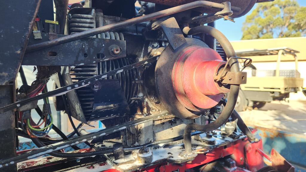

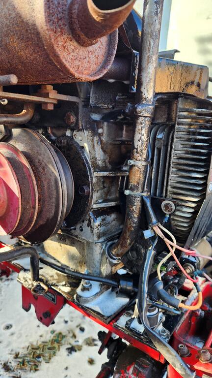

Red Stallion 109 #18 Posted January 17 Already starting to look much cleaner... I can actually see the engine block! 5 Share this post Link to post Share on other sites

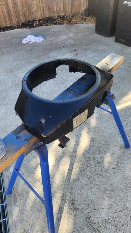

Red Stallion 109 #23 Posted January 18 First of many painting sessions... only had flat black, but I prefer that to gloss anyway. Still cleaning gunk off the engine. Picked up some degreaser and a gun, and giving it a spray, every couple of hours. But its probably 90% clean! Also been trying to find parts all day. Nobody stocks the oil filters near me, but I think I've found someone other side of the country. And also found an almost similar rear light in LED that I might get. Still need to pull the $150 trigger for the filter grommet, and the oil filter gasket. Share this post Link to post Share on other sites
Red Stallion 109 #24 Posted January 18 (edited) I can see silver! Edited January 18 by Red Stallion 2 Share this post Link to post Share on other sites
953 nut 57,706 #25 Posted January 18 On 1/16/2025 at 10:03 PM, Red Stallion said: covered it dust, mud, spider eggs, grass, and everything else. I have an assortment of bottle brushes that are great for removing crud safely. 2 Share this post Link to post Share on other sites
