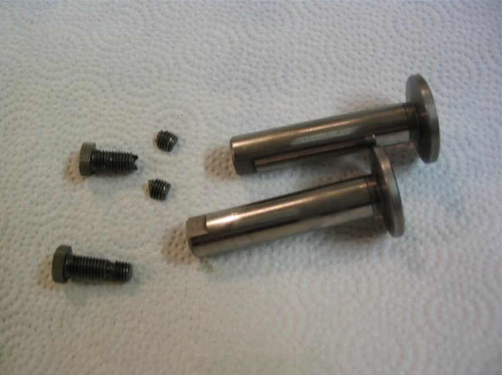

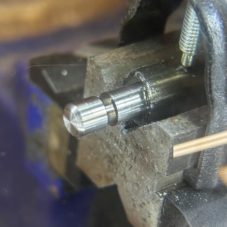

Tinkerer3 5 #1 Posted January 13, 2025 Howdy all, I'm in the process of replacing valves on a k341 with the hope of curing a random misfire/backfire. This week, I got new valves from isavetractors and I have to say buying from Norman has been outstanding. My issue is the old intake valve has some signs of being shortened, and the new intake valve is just .002 too long with the adjuster fully lowered or atleast lowered till I hit a hard stop. Question for the experts: Could you remove those adjuster bolts? What prevents those bolts from turning while the engine runs? Can I sand that bolt head to get the extra .002 I need for .009 intake gap? Any ideas on what could have been done in the past that would make that lifter taller? Thanks in advance for any info or ideas Share this post Link to post Share on other sites

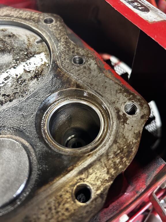

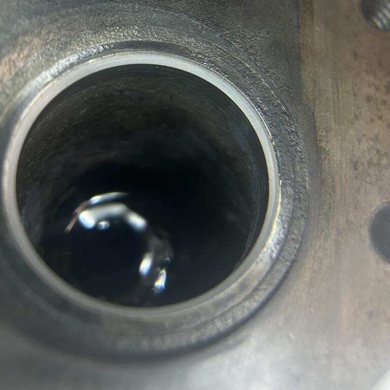

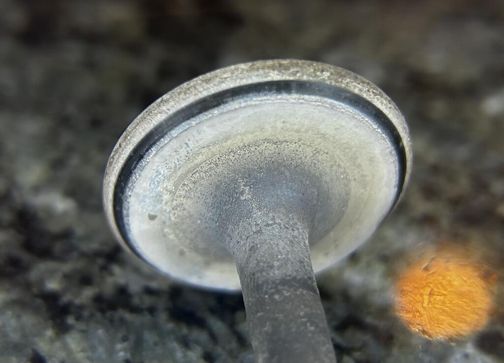

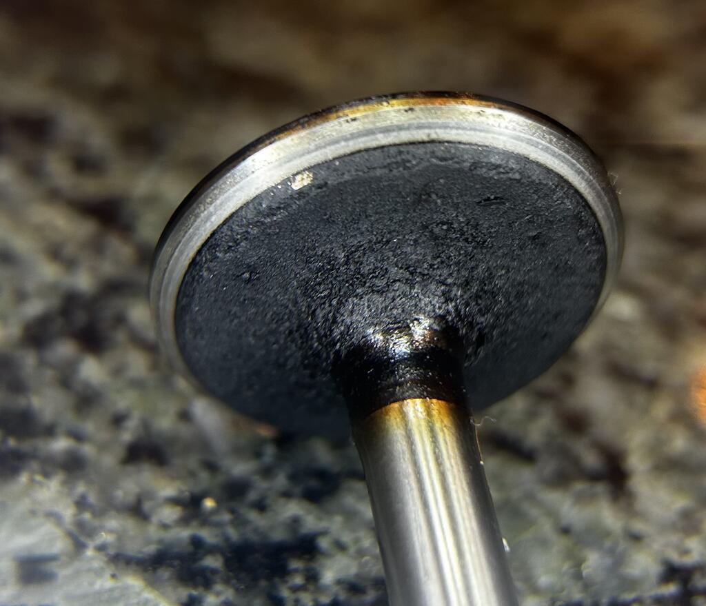

Tinkerer3 5 #3 Posted January 13, 2025 Thanks for the quick reply. You're right about a leak down; it should be next on the list of to-dos. I was planning on replacing the valves since that seemed pretty cheap and easy. It also seems like a good culprit for my random miss/backfire. The old valves sat pretty high on the valve seats, and the new exhaust valve fits fine. But that is a great point, as the length issue could be at the valve seats. I'll post a photo to show where the seats hit the old valves and the tappet to see if anyone thinks I can get that adjuster lower or sand it on glass. Share this post Link to post Share on other sites
ri702bill 13,095 #4 Posted January 13, 2025 (edited) Not bad - seen a lot worse. Next to check - the condition of the valve guides - wear & clearances. Both the valve stems & guides wear as the valves move up & down. There should be NO discernable "side to side rattle" in the working area. Valve guides are replaceable but DO require reaming once installed to get the proper fit for valve clearance. NOT a pistol drill job!! SOMETIMES - replacing the valve with an unworn NEW one in a used guide will remove just enough of that rattle to buy you time for a complete proper fix... Edited January 13, 2025 by ri702bill 1 Share this post Link to post Share on other sites
Achto 32,795 #5 Posted January 13, 2025 (edited) Personally I would shorten the valve stem. A few touches on a grinder wheel should get you where you need to be. Don't forget to lap you new valves to ensure a good seal. The adjusters are an interference fit on the threads. I have never seen them back out. Edited January 13, 2025 by Achto 5 Share this post Link to post Share on other sites

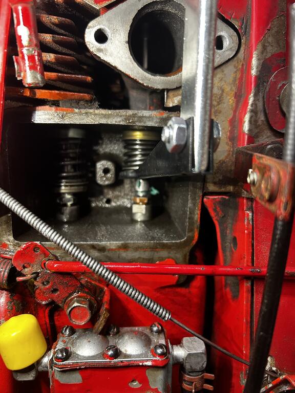

OutdoorEnvy 1,817 #6 Posted January 13, 2025 Hey not meaning to doubt your work but just to double check a few things based on how you asked some questions. ' Verify your engine is at top dead center with the piston at top and both valves closed completely. They don't look even in the pic you provided and should be if it's at top dead center. Even though the valves are new you'll still need to seat them with valve lapping compound The screws do appear to turn with engine running but the whole assembly turns as those are like lock nuts under them. So it takes two wrenches to adjust these screws. You use one to hold the lock nut part still while you tighten or loosen the screw. It is usually pretty tight feeling. Also your clearance is determined with the spring and keepers installed. 2 Share this post Link to post Share on other sites

Tinkerer3 5 #8 Posted January 13, 2025 I found some photos of Ford Model T lifters, and it seems like the locking bolt might have a machined gap making the lower threads create more friction? Also thinking these bolts have to be hardened metal and would be very hard to sand or file? Has anyone ever removed one of those bolts? Share this post Link to post Share on other sites

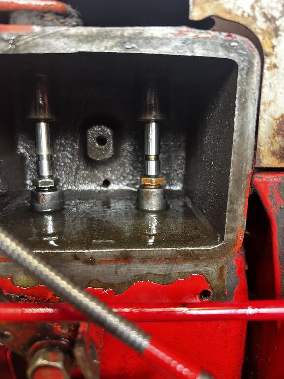

squonk 48,163 #9 Posted January 13, 2025 Lets have a pic of the seats in the block. 1 Share this post Link to post Share on other sites
Tinkerer3 5 #10 Posted January 14, 2025 Great request I should have added one of those originally. 2 Share this post Link to post Share on other sites
Tinkerer3 5 #11 Posted January 14, 2025 Update: At TOC the intake lifter is higher than the exhaust. I'm not sure what lifter was used or why it would be a taller lifter? I do think, at this point, I'm going to take a little off the valve stem, lap my new valves, and see how it runs. 1 Share this post Link to post Share on other sites
squonk 48,163 #12 Posted January 14, 2025 Are you sure you are on the compression stroke? The intake valve will start to open as soon as the exhaust valve closes. I know of no reason to have a longer lifter. Kohler manual shows 1 part # for both lifters # D235327 Share this post Link to post Share on other sites

squonk 48,163 #21 Posted January 20, 2025 (edited) 1 hour ago, Tinkerer3 said: I did not know that the motor had a ACR at low rpm. But it makes sense. I tested compression at full throttle. I'm going to have to do some research on how the ACR works and how it could affect the lifter. Your lifter was on the ACR Lever. That's why it was higher than the intake lifter. You need to adj the gap with it off of that lever Edited January 20, 2025 by squonk 2 Share this post Link to post Share on other sites

squonk 48,163 #24 Posted January 21, 2025 I don't think you can see it. Can you post a video of the lifters going up and down as you rotate it? I can't think of a reason why the lifter would be high all the way around the cam unless the lifter itself was stuck. Even if the ACR spring was broken I think the ACR lever would be lower unless the spring itself was jammed under the lifter. Take the cover off. Won't hurt. 1 Share this post Link to post Share on other sites
