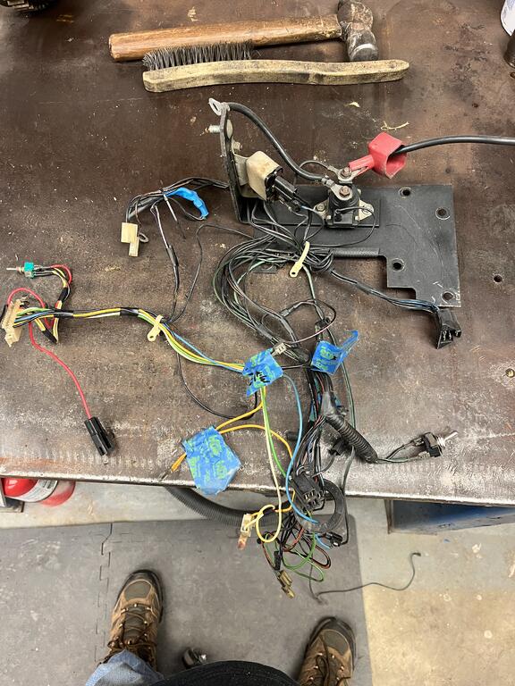

Wvtroutbum81 304 #1 Posted January 6 Can you remove all the safety switches? Remove all the excess wires. What about the relay? Whats it for? 1987 312-8. Reason is circuit board is melted and dont want all the extra wires Share this post Link to post Share on other sites

squonk 44,860 #6 Posted January 6 I believe that relay pictured is the engine kill relay. Leave that out and the engine won't shut off. Hi-Jinx will ensue! Share this post Link to post Share on other sites

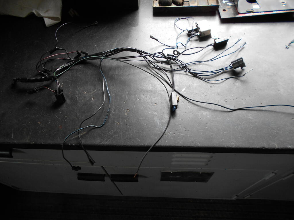

cleat 8,069 #7 Posted January 6 (edited) 54 minutes ago, squonk said: I believe that relay pictured is the engine kill relay. Leave that out and the engine won't shut off. Hi-Jinx will ensue! Actually, that silver relay beside the start solenoid is the low oil relay that prevents the engine from cranking over if the oil level is low. After building wire harnesses for the 520's that 312 harness is fairly straight forward. If you follow the wires from the circuit board and just remove those then what is left will not be too bad to follow. The 312 does not have too many safety switches, main ones are the clutch, PTO, oil level, and seat. Here is the harness from my 312-8 with the warning circuit board wiring removed. You will notice the seat switch wires are also removed. That is because to mow steep hills and ditches I sometimes need my butt off the seat for stability. Edited January 6 by cleat 5 1 Share this post Link to post Share on other sites
