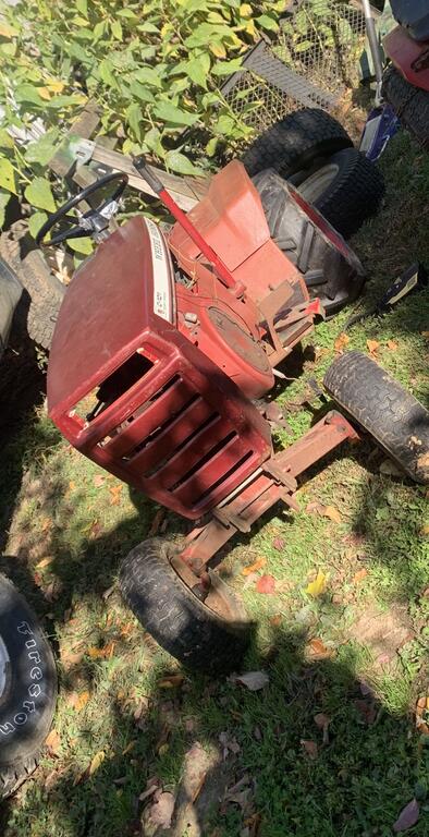

Cowboy2684 1 #1 Posted January 1 Need some pulling hitch ideas for my c101 thanks 1 Share this post Link to post Share on other sites

TonyToro Jr. 1,749 #3 Posted January 2 Here’s what we did which our pulling tractors order a Cub cadet pulling hitch. (The ones that seal the back of the transmission) Then weld 2 nuts on the bottom. Then get a piece of flat stock and weld it to the top. Then drill 2 holes through that and mount the top part of the hitch to the top 2 bolts that are on top of the transmission next to the dipstick. Then get a piece of rod and but it through the hitch hole in the back of the transmission. Thats my 1 Share this post Link to post Share on other sites
SylvanLakeWH 27,532 #4 Posted January 2 10 minutes ago, TonyToro Jr. said: Here’s what we did which our pulling tractors order a Cub cadet pulling hitch. (The ones that seal the back of the transmission) Then weld 2 nuts on the bottom. Then get a piece of flat stock and weld it to the top. Then drill 2 holes through that and mount the top part of the hitch to the top 2 bolts that are on top of the transmission next to the dipstick. Then get a piece of rod and but it through the hitch hole in the back of the transmission. Thats my How about a picture or two? Might help him out with design ideas... 2 Share this post Link to post Share on other sites
TonyToro Jr. 1,749 #5 Posted January 2 25 minutes ago, SylvanLakeWH said: How about a picture or two? Might help him out with design ideas... Will do tommorow. Share this post Link to post Share on other sites
