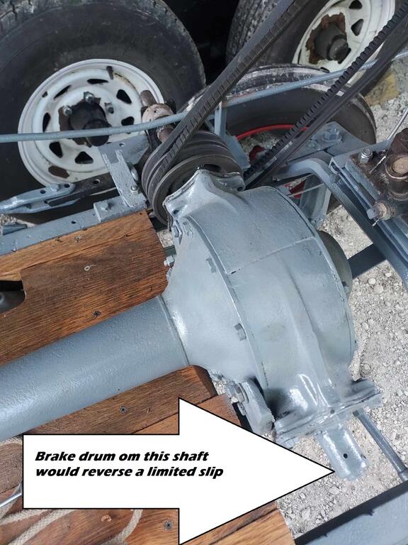

953 nut 57,768 #20 Posted December 30, 2024 I also agree on the flat belt with wooden pullies which would have been time appropriate for this build. If the differential that is being used as a right angle gear was a a limited slip it could also be used for reverse. 2 Share this post Link to post Share on other sites
Ed Kennell 40,415 #21 Posted December 30, 2024 7 minutes ago, 953 nut said: I also agree on the flat belt with wooden pullies which would have been time appropriate for this build. If the differential that is being used as a right angle gear was a a limited slip it could also be used for reverse. Care to explain this Richard. I was assuming this axle would have been permenantly locked to allow power to be transmitted from the other axle to the drive shaft. Share this post Link to post Share on other sites
953 nut 57,768 #22 Posted December 30, 2024 3 minutes ago, Ed Kennell said: Care to explain this Richard. I was assuming this axle would have been permenantly locked to allow power to be transmitted from the other axle to the drive shaft. Looking at the first picture you posted I too figured the axle stub was welded to the flange. In the close-up I saw the hole drilled for a pin and the axle didn't appear to be stationary. Wish I knew what the right angle drive differential came from so I could dig a bit deeper into this theory. I don't know if there were any limited slip rear ends at that time, but if the stub axle turned with the driven axle going forward I would think it would reverse the output at half the speed when it was stopped by the brakes. Or it could be wishful thinking and I'm barking up the wrong tree. Once you buy it and get it home you can check this out a bit further. Share this post Link to post Share on other sites
