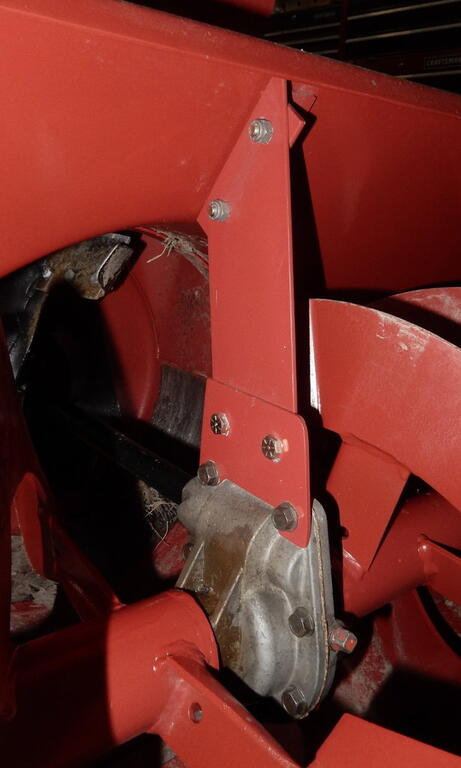

Ed Kennell
Here is a104_2152.JPG.9af36418e8beb89884c1160522cef004.JPG pic of the support on my Ber Vac.
WHX??
18 hours ago, JCM said:
  @WHX??  I think posted some time ago that took the sway out of that shaft that bolts to the center of the blower housing directly above it.
A mod I got from other guys here
Yep looks like Ed's Ber Vac has one similar.
Edited by WHX??
  • Like 6
R Scheer
Very nice looking blower.  What is the thickness of the support, about 1/8"?
