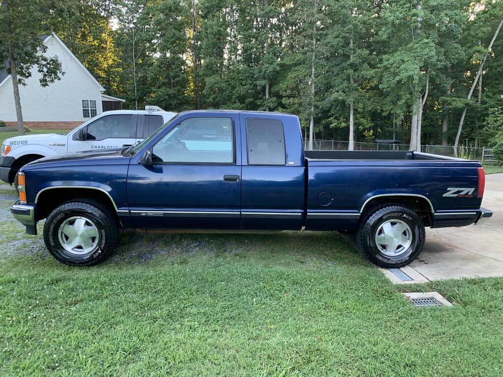

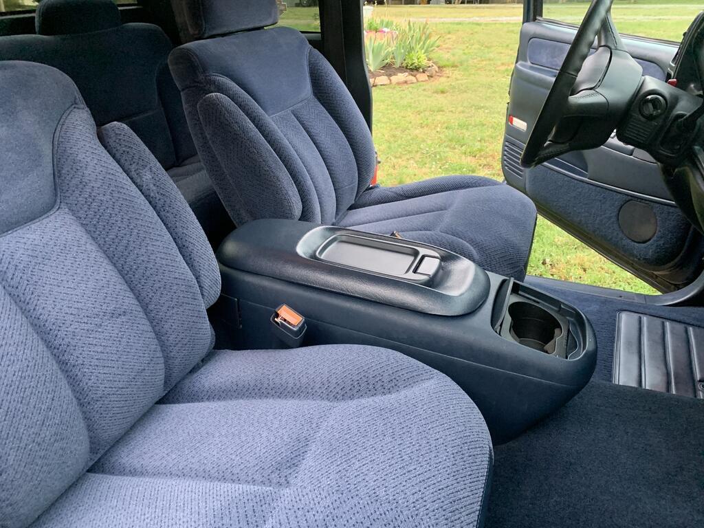

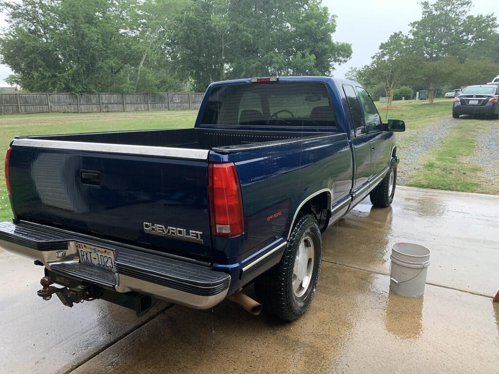

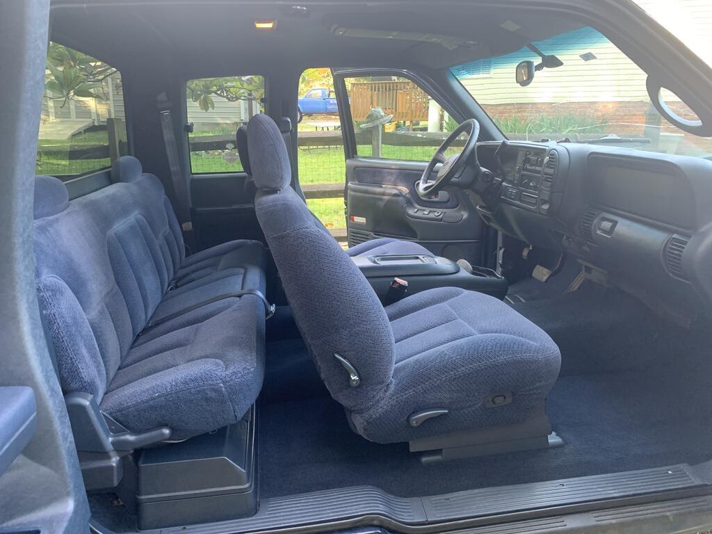

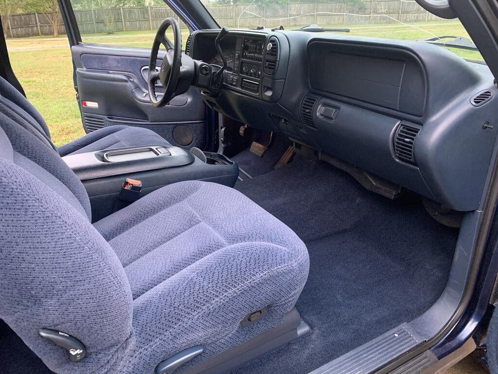

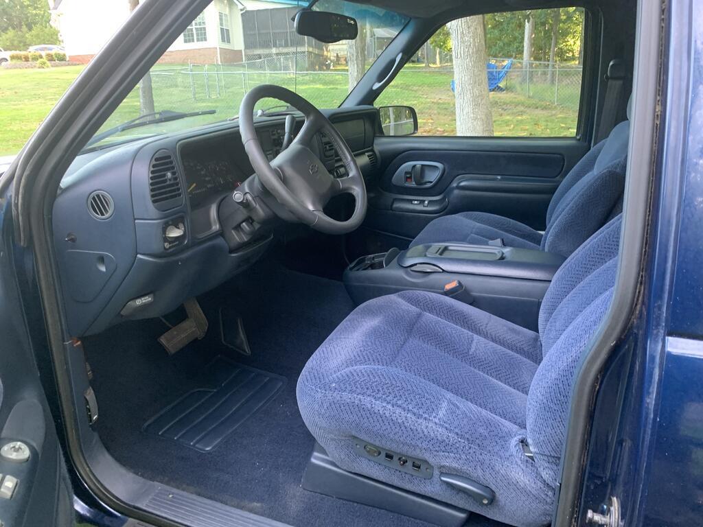

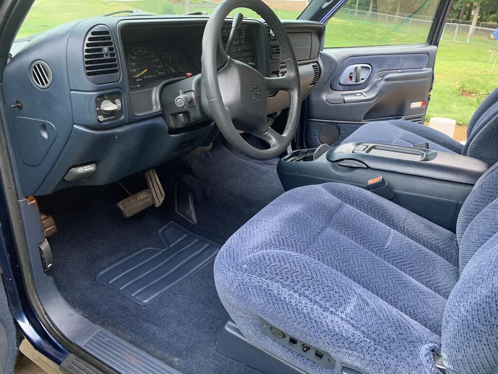

Horse Newbie 7,195 #24 Posted December 26, 2024 (edited) I run a 1998 Chevy K1500 Z71 Silverado. 280,000 on the clock. Had a sun gear or something like that replaced in the transmission somewhere around the 100,000 mile mark… not sure. Transmission guy said a common problem with that year as the gear was made out of cheap metal or plastic ( not sure which) He replaced with an aftermarket gear made with a higher quality metal and assured me that I would have no more problems with that. Just made a trip from Monroe NC to Cowen WV and avg 16.9 mpg at mostly 80 mph. Libby keeps saying I need a newer truck… no thank you. And besides now that people have bought up most of the square bodies, they are now going nuts over the era of Chevys and GMC that my ‘98 is in. I have heard that the 5.7 liter Vortecs in it are real reliable, although plagued by pesty rear main seal oil leaks. For now I can live with that. Edited December 26, 2024 by Horse Newbie 1 6 Share this post Link to post Share on other sites
