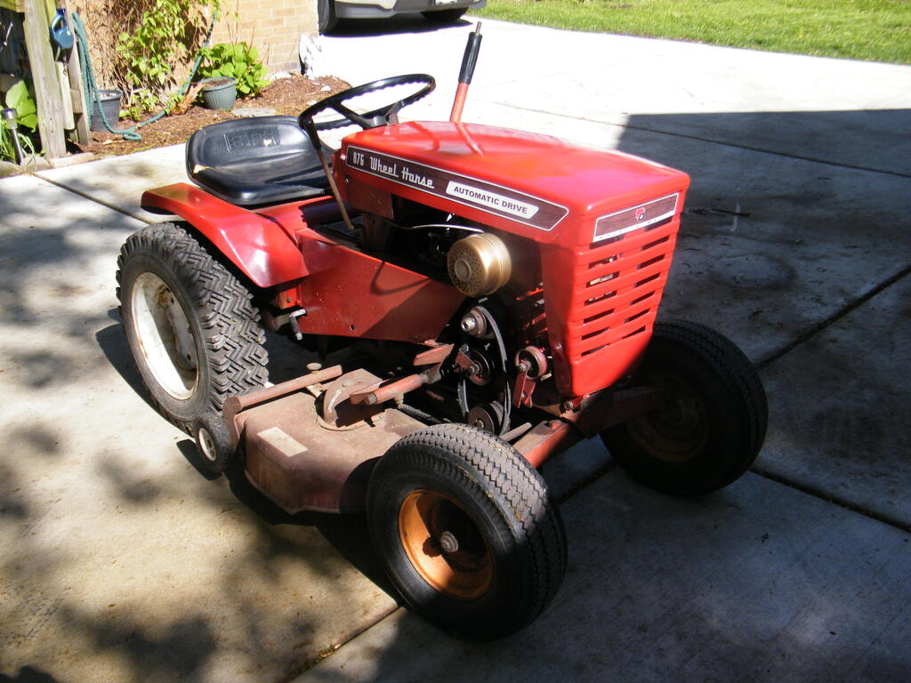

stevasaurus 23,758 #3 Posted December 24, 2024 Do you have the guide pulley that bolts on the front bolt of the attach-a-matic? Shown in front of the mower belt. Share this post Link to post Share on other sites
adsm08 4,834 #4 Posted December 24, 2024 (edited) 1 hour ago, stevasaurus said: Do you have the guide pulley that bolts on the front bolt of the attach-a-matic? Shown in front of the mower belt. No. But if I found one I'd probably grab it. Edited December 24, 2024 by adsm08 Share this post Link to post Share on other sites
adsm08 4,834 #5 Posted December 24, 2024 @stevasaurus I just found another thread from 2016 where you posted up detailed pictures with dimensions for that bracket. It looks like that's something I can build, and Lowell appears to have the pulley. 1 Share this post Link to post Share on other sites
stevasaurus 23,758 #6 Posted December 25, 2024 @adsm08 You know, I forgot that I had all those pictures. @Pullstart was looking to put that blower on the 702 last week. Those pictures would have been nice to show him. Kevin, I can still send those pictures to you...you should have them. @adsm08 yes, you can make that part, and if you can't find one, it is the stuff you need to make that blower work. 1 Share this post Link to post Share on other sites
