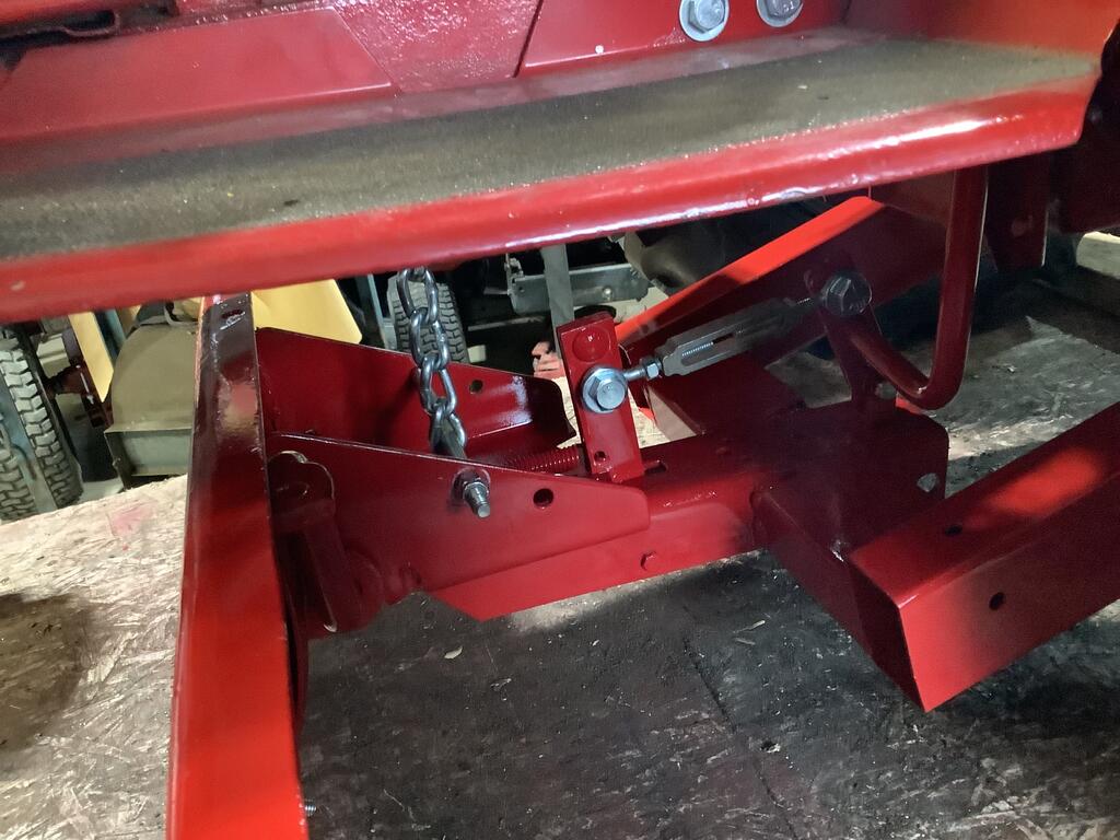

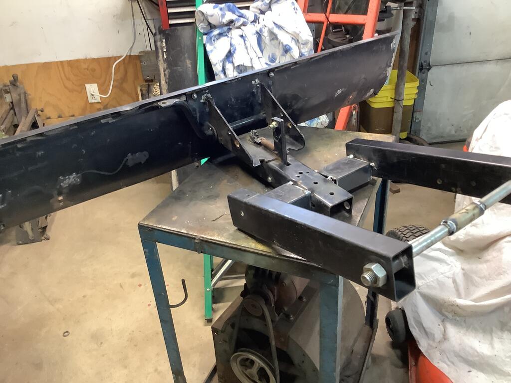

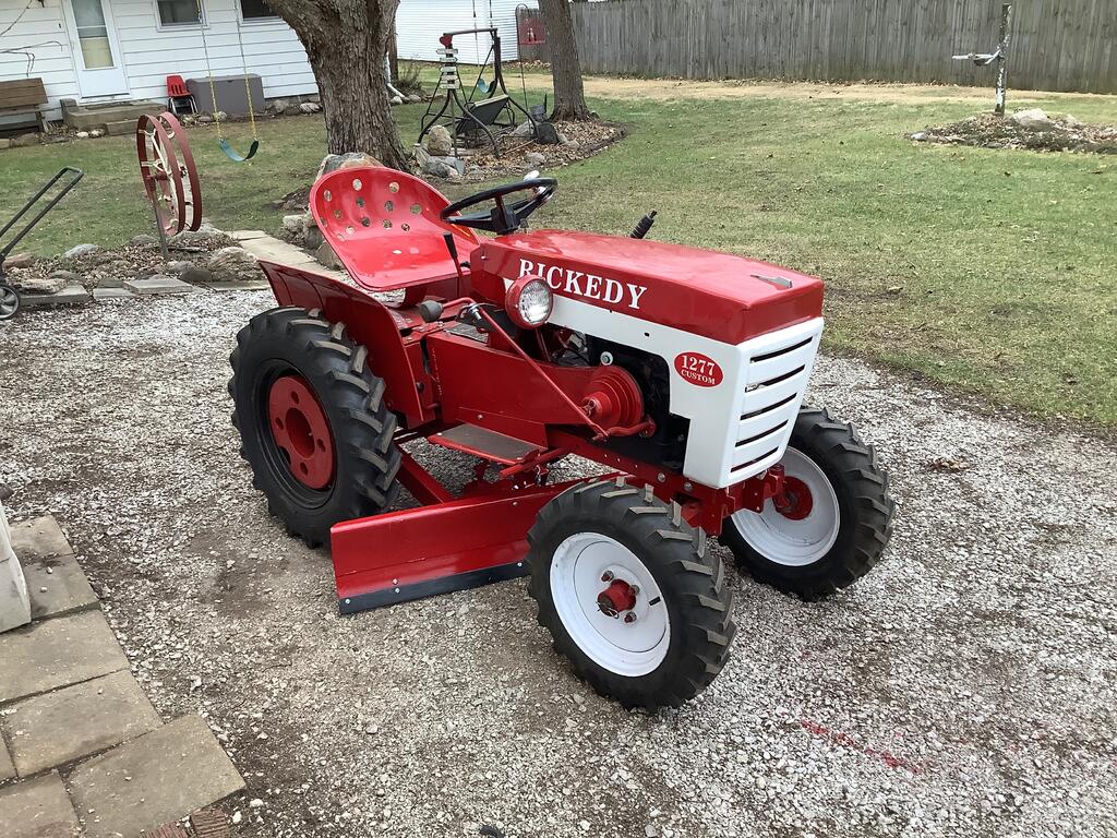

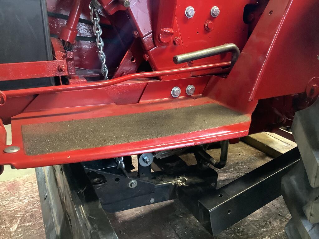

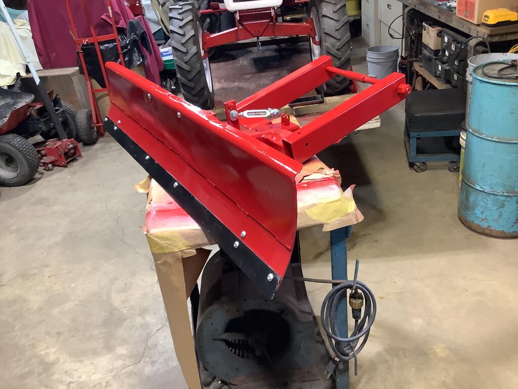

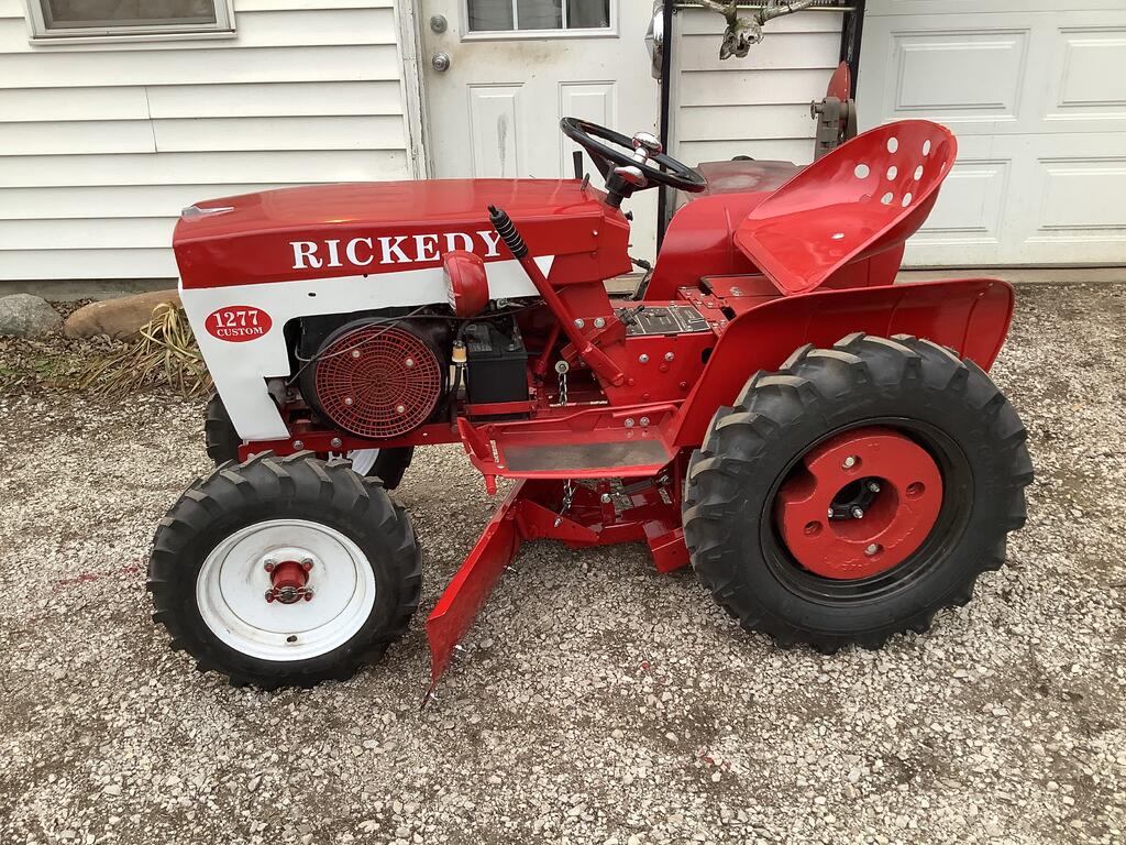

CRF857 291 #1 Posted December 23, 2024 I was given 4 Craftsman snow blades. Three were 42”, and one 48”. Only one had any of the mounting brackets. I had an itch to make a mid-mount grader blade. I started by cutting the 48” blade length ways just above the mounting plate. Then overlapped that piece onto the lower part. Welded it together. That reduced the height from 14” to 9.5”. Then I made a framework to attach to the rear axle. Test fitted to the tractor a few times for functionality before welding solid. Made up a lever to release the pivot lock. It comes out just above the floorboard on the left side. I can easily reach it and pivot the blade with my feet.Got it all painted and reassembled. Drove it outside for a few pictures. (Damn few, its cold out there.) Thought I would share with you all. 6 8 Share this post Link to post Share on other sites

peter lena 9,556 #4 Posted December 24, 2024 @CRF857 nice solid detailing , shows solid past equipment experience . that turnbuckle set up , just makes sense , those are great to dial in spring loading , so many opportunities to improve attachment set ups , nice job , pete 3 Share this post Link to post Share on other sites
CRF857 291 #5 Posted December 24, 2024 I can reach the blade with my feet to add down pressure. After using a few times I may strengthen the lift point and go with a solid lift link. For now I don’t want to get it dirty. 2 2 Share this post Link to post Share on other sites

953 nut 63,003 #9 Posted December 24, 2024 Nice job on that mid mount and the fabrication pictures. Not only the blade but the custom work you have done on the 1277 looks great too. Please tell us a little about the wheel sizes and other modifications you have made. 1 Share this post Link to post Share on other sites

CRF857 291 #11 Posted December 24, 2024 1 hour ago, 953 nut said: Nice job on that mid mount and the fabrication pictures. Not only the blade but the custom work you have done on the 1277 looks great too. Please tell us a little about the wheel sizes and other modifications you have made. The front rims are from a boat trailer, with 12” tires I already had. The rear rims are Jeep Cherokee space saver rims with 6:00x16 tires. Fenders were off a Cub Low-Boy, trimmed to fit. Seat is from…???. 16 hp Kohler. I was trying to mimic the looks of an IH 560. 1 2 Share this post Link to post Share on other sites
