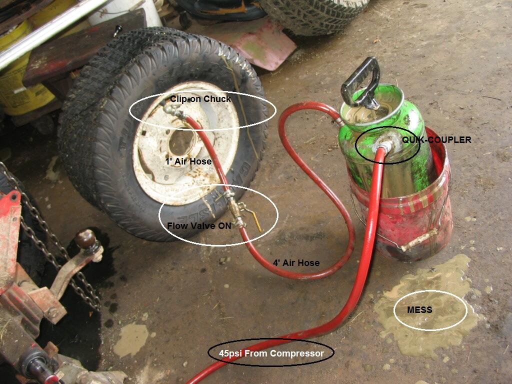

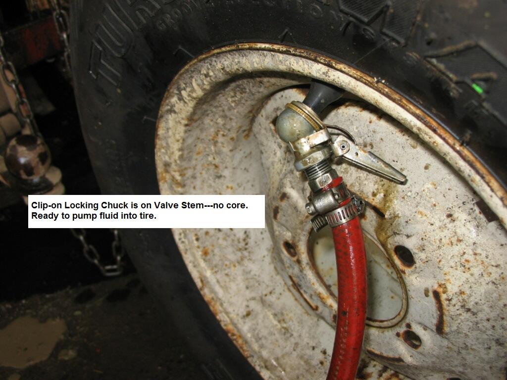

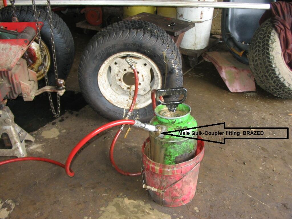

daveoman1966

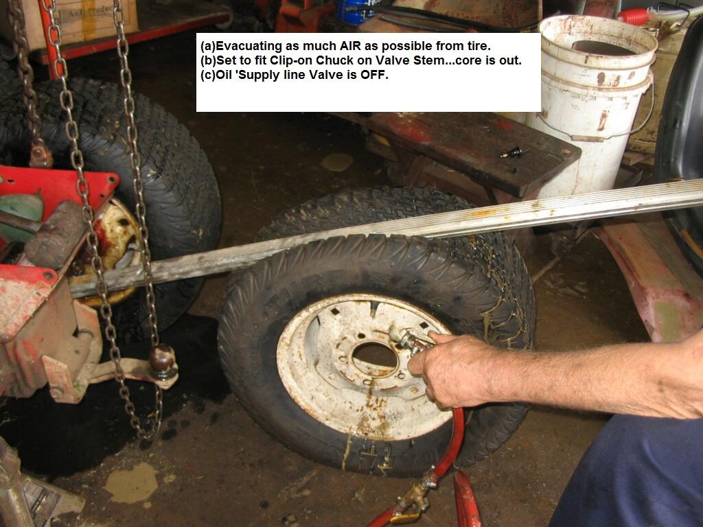

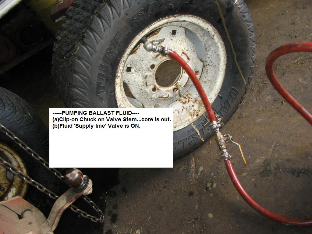

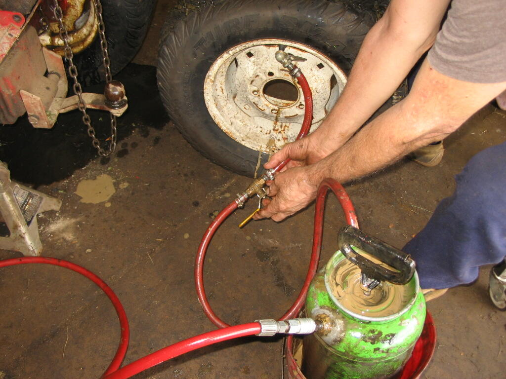

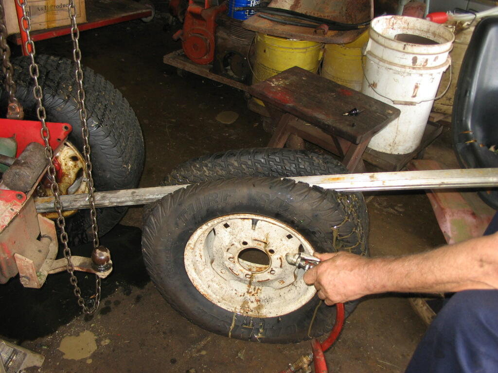

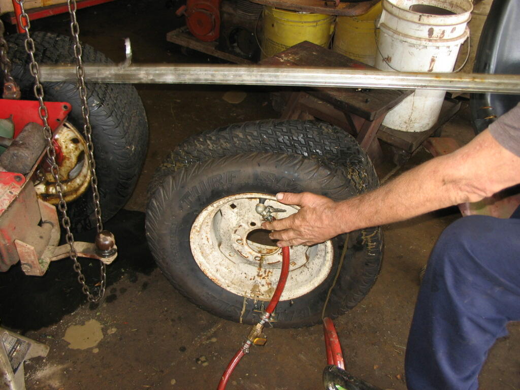

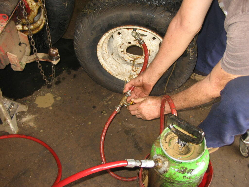

I filled the 23x10,5x12 with used motor oil.  It won't free and inhibits any rust on the rims. Here is what I did....very little mess.
16845509_oilintire008.JPG.d90ae839fbf4f9e2288e9c53e93ba5e2.JPG1334376739_oilintire007.JPG.ea10e499937e99f213779589bb5b254b.JPG954261018_oilintire006.JPG.c4cda94434a6305baeee5e1054aa75c5.JPG1818351377_oilintire005.JPG.a6b2895606dd89adf88a1b40c8b45aa2.JPG1559750841_oilintire004.JPG.d258143d2ac0040f22625ba61c61a91c.JPG395143360_oilintire003.JPG.95b50338cd60d9329986d56df7148e8f.JPG1526326080_oilintire002.JPG.f3e99be99e1c0ca1a5eb24dcc134f6f6.JPG848786779_oilintire001.JPG.ed5884dbae8052654ac0df589f2c63ad.JPG1139001753_oilintire009.JPG.23b74eaa9f55a4d1f7e3f6a836d2be35.JPG

Dave - agreed it will neither freeze nor allow the rims to rust. Tire bead and valve stems OK with that?? The mess seems to be delayed until it's time to dismount the tires....:confusion-waiting:

daveoman1966
Been there for 4 or 5 years and no issues with the valve stems.  You'll have a MESS with ANY liquid use to fill the tires..
