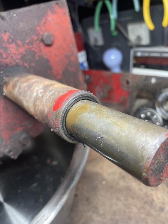

Maynardb 19 #1 Posted December 19, 2024 Hi im rebuilding a trans for my suburban and have a spare for parts. The original trans had the cap style axle seals which cost you your first born, while the spare trans has small neoprene ones that fit in the small recess at the end of the housing. Both housings have that recess, so can I use the small ones instead? My guess is they are a lot cheaper so what do you all think? Or is it that they both should have a neoprene o-ring in that groove, with the cap style seals on top? thx Share this post Link to post Share on other sites
wallfish 20,553 #2 Posted December 19, 2024 If they seal the oil from coming out it's good to go. Shouldn't be any O rings in there that I know of 1 Share this post Link to post Share on other sites
Maynardb 19 #3 Posted December 20, 2024 Well, it leaks a bit, but I attribute that to worn bushings. It looks like a real lipped seal but it’s pretty narrow Share this post Link to post Share on other sites
