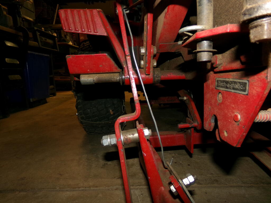

Ed Kennell
Shim it out and or bend it to suit.   Here's my shimmed out to clear my motion control pedal on my 312H.

You won't need an 8" shim. See Ed's Pic.
The pivot point is in FRONT of the 3/4" rod that holds the brake pedal. Once your plow frame is in place you'll get a better understanding of how things line up.

Ed Kennell
A little more involved, but they can be bent forward and back as well as left to right.P5060239.JPG.3328c5312f06c9753684a0b7e040461b.JPG

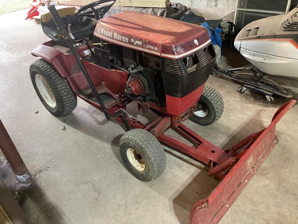

MainelyWheelhorse
I built mine. I used a handlebar grip, a piece of handlebar sized tubing, a flat bar bent to clear everything, a bicycle handbrake with the cable, connected to the triangle. I still have all the other pieces in case I want to go back to stock though.
  • Like 1
  • Excellent 3
  • Heart 1

@MainelyWheelhorse looking at your setup it looks like you have the same foot rest / brake / lever issue I think I'm going to have.
I just don't see how the lever won't hit the brake! That's why I thought I'd need an 8+ inch spacer - to basically make my lever stick out past the brake the same way your handmade lever does. Nice job btw!
I'm not as handy with fabbing... So I'll have to come up with something.
