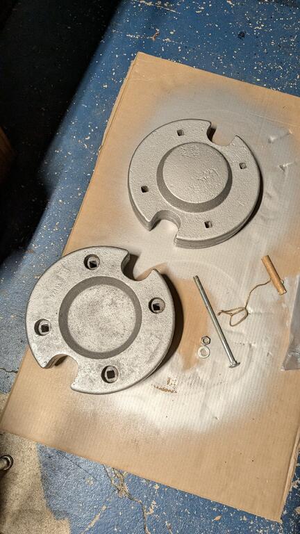

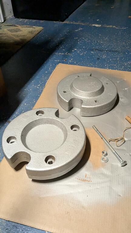

Hey guys, anyone know which way these wheel weights should be installed? I'm assuming these are aftermarket and not WH brand. They appear to be cast iron. Not sure which side goes on the inside of the rim and which side faces out
Also, anyone know what the purpose is of the half circle cut outs on either side? Just curious at this point! Thanks
ebinmaine
The half circles are there for a couple reasons. One for you to hold on to. Also to line up with a valve stem if there was one. Our valve stems are on the inside and those wheel weights go on the outside so it won't matter to you.
As for position, I would put them on the outside of the wheel with that bump in the weight facing the inside as long as they fit that way.

They look similar to a pair of John Deere weights I was given. The recessed holes pretty much indicate that the center hump goes towards the hub. I assumed the hump is for stacking/aligning multiple weights.

Those are similar to John Deere weights (JD weights have a round hole for the mounting hardware vs the square hole).
They can mount either way, but most mount the dish inward.
They are stackable, add as many as you need.
