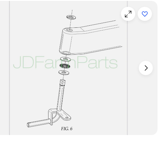

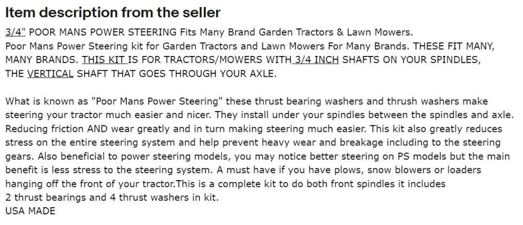

Saw these on fleabay & price was somewhat reasonable. Not that I would buy them ...just not seeing how the they would work on a horse without shaving off the bottom of the axle and getting the e-clip on.

lynnmor
You can put together your own kit with parts from McMaster-Carr.  The thrust washers are available in different thicknesses, but McMaster reduced the number of thicknesses they offer so I did find a supplier for what I wanted.  I might be able to find it, but not today.  Many tractors  (all of mine), have excess play and I actually use old thrust washers on top to help prevent dirt intrusion.  You will need to use the hardened washers on both sides of the roller bearings.
My 520-H swept axles all had these from the factory. But they ride in a recess in the bottom of the axle. I think this helps in keeping the crud out. They definitely make steering easier so long as they are clean and greasy. Especially true for over size tires or heavy weight up front.

Ed Kennell
Just D & T the top end for a bolt like some of the older "good" spindles.

ri702bill
Nice idea, but a few words of caution.....
The top of the steering arm, shown where the washer & rotary thrust bearing wii go MAY not be flat and true to the axle boss. Check for even wear... IF only one corner is in contact, you run a very good chance of cracking the hardened washers and damaging the bearing. The entire weight load and vibration are concentrated into a tiny area. Like comparing the area of a Flip-Flop to that of a high heeled shoe....
Having machined several axles to allow room for bushings or bearings while still only having .010" gap under the retaining ring to the axle, I have seen what I described above on at least one.

Handy Don
Bill flattened and shortened the bottoms of a 312-H axle for me to make room for thrust bearings (a HUGE improvement for steering) and still get the clip on. I was very surprised at how far NOT in planes perpendicular to the bore they were.
We also looked at the spindles where standard washers are welded to the ¾” rod to support the axle. Fortunately, they were darn close to “in plane” -- probably because a jig was used during manufacture.
  • Like 2

953 nut
I shaved a bit of the TOP of the axle since the bottom would need to be dead flat but the top could be a bit off without a problem.

WHX??
Seller only wanted 20 bucks.. I doubt one could get them from MC for less than that. Yes I am frugal ... :lol:
