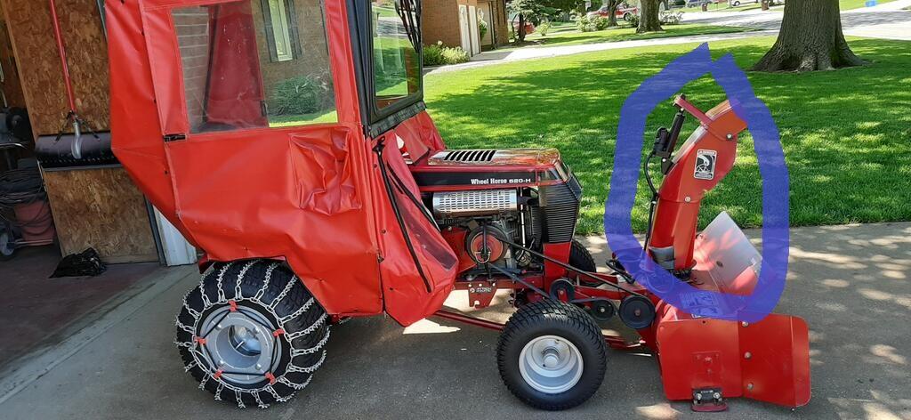

14 minutes ago, Lagersolut said:
What for set up is that in your 1st picture with the chute/deflecto
It's a just short chute model that got painted PO black. Some situations a short is desirable as it plugs up less. Light powder & light wet heavy stuff but they are not as well mounted as a tall and it can rip right off with wet heavy in big amounts. Plus they are cable turn which can be a pain.

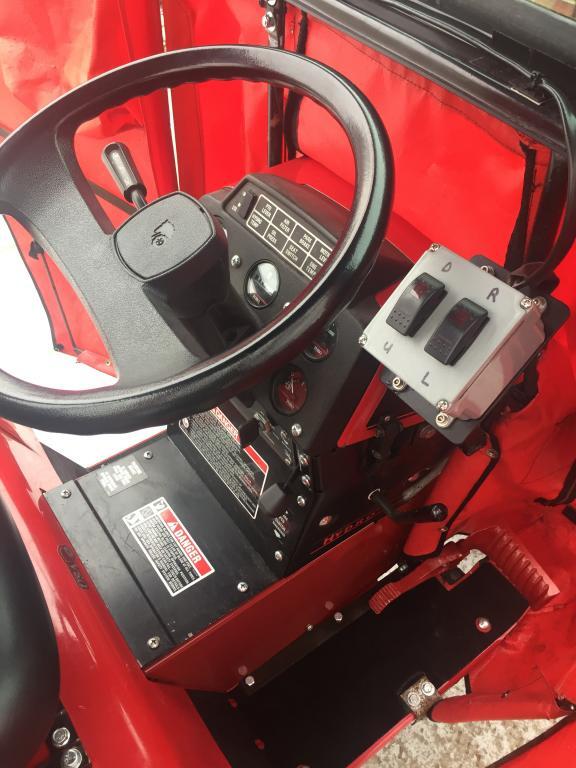

I think he was asking about the E-chute controls Jim. ??

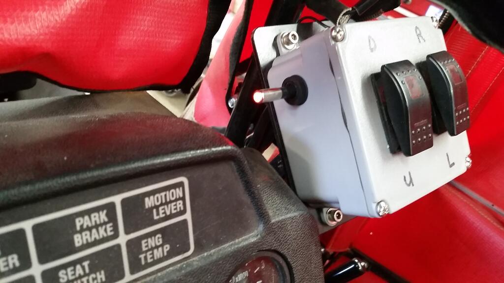

This one with the chute controls
WHX??
Ahhh my bad ...first pic... Those are @dclarke 's creations. Electric turn and deflector actuators.  A popular and VERY handy mod. Wished I had it on the deuce. He did a bang up job on them. The turn motor is a car power seat motor or power window operator I forget.  The deflector is just a linear actuator. both wired to switches in the cab.
Edited by WHX??
  • Like 1
  • Excellent 1
Ed Kennell
          Wow, what a cool set-up.      If I had any hope of ever getting to use my Ber Vac deuce, I would  swipe a couple motors out of Mrs Ks new SUV and E-control the chute.
