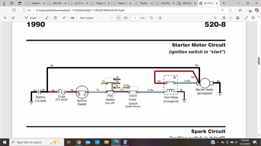

gwest_ca-(File Mod) 11,121 #2 Posted December 3, 2024 Download this file. Each circuit has it's own diagram making it easy to follow. They illustrate what it takes to make it work. 1 Share this post Link to post Share on other sites
Handy Don 12,568 #3 Posted December 3, 2024 32 minutes ago, dkg520 said: Anyone have any ideas on where I should start. Thanks for any help. I always start with obvious connections--are they clean and tight? Battery positive and negative? Ground from battery to engine? Connections to the ignition switch? Connections to safety switches? And, specific to the Onan-powered tractors, any visible damage or overheat evidence at the 9-pin connector that links the engine wiring to the tractor? Then look for broken or frayed wires. I’m not directly familiar with that model, but in your situation, “no life when trying the key”, I’d look for problems at the safety switches--disconnected wires or broken switches, for example. Clutch, seat, and PTO safeties can all affect start/run. Use the wiring guide to look for continuity and voltages as you trace the wires. I’m assuming you have a working volt/ohm meter and know how to use it, of course! Take NOTHING for granted -- I even, sometimes, distrust a new battery until I’ve tested it. 2 Share this post Link to post Share on other sites

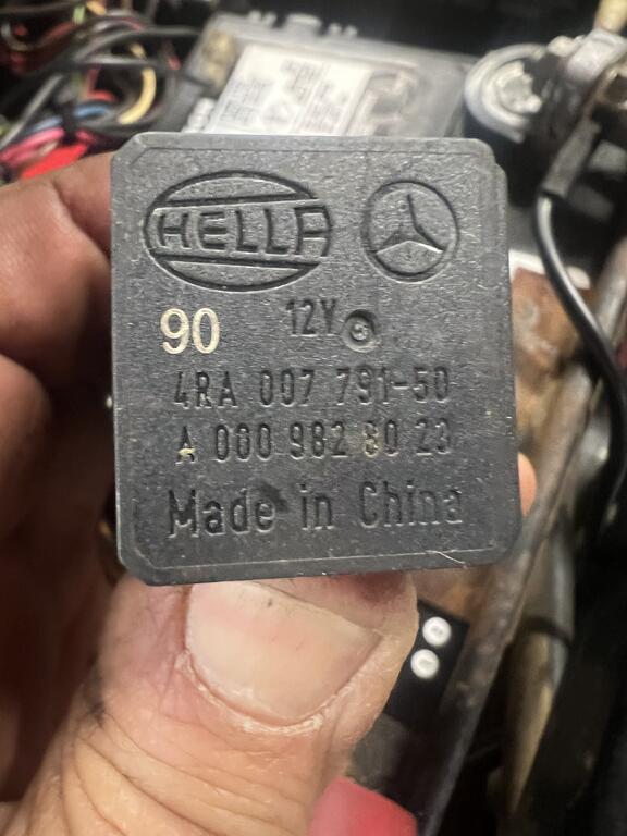

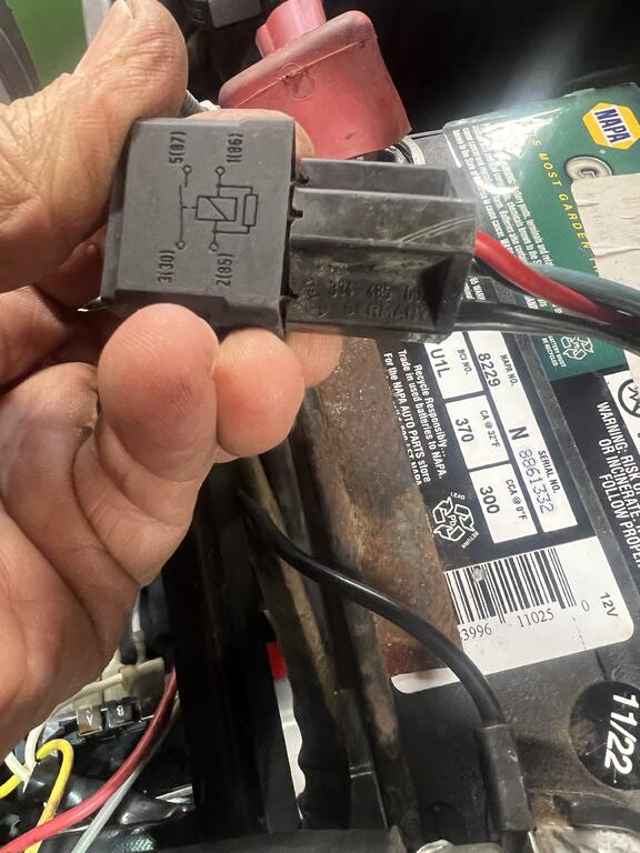

dkg520 510 #22 Posted December 5, 2024 Well guys let me start by thanking everyone for their help with my problem. Today I tracked the problem down to the 9 pin connector. I took it apart to look for any signs of heat or burning but when I put it back together the machine started and ran perfect. I’m still not quite sure what the permanent fix for the problem is but it’s running again. Thank you all 1 Share this post Link to post Share on other sites
Handy Don 12,568 #23 Posted December 5, 2024 13 minutes ago, dkg520 said: Well guys let me start by thanking everyone for their help with my problem. Today I tracked the problem down to the 9 pin connector. I took it apart to look for any signs of heat or burning but when I put it back together the machine started and ran perfect. I’m still not quite sure what the permanent fix for the problem is but it’s running again. Thank you all Great news! Guys have taken a couple of approaches to balky 9-pins: a replacement connector (available from Wheel Horse Parts and More, a vendor here), or new, waterproof 2- and 3-conductor connectors. Not all 9 pins are used in the existing connector. That connector was a significant expedient for WH during manufacture when connecting the engine to the tractor but that type is vulnerable to moisture and corrosion. Share this post Link to post Share on other sites
