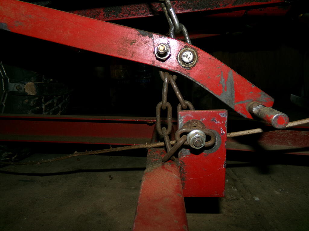

Ed Kennell 40,395 #7 Posted November 30, 2024 I attach the plow frame to the deck lift bar with a chain. Easy peasy if you don't need down pressure. 1 2 1 Share this post Link to post Share on other sites

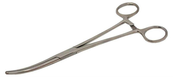

Ed Kennell 40,395 #9 Posted November 30, 2024 I use these to install hairpin clips, nuts and bolts in tight places. 1 Share this post Link to post Share on other sites
peter lena 9,074 #10 Posted November 30, 2024 @Frank DeHaven yes that dash face removal is what you want to help you , would also washer up , the sloppy trunnion type , lift connection point , while you are in that area , get some red aerosol spray grease , extension tube , get it into every movement area , make the rust run out ,bronze bushings at end areas , @Ed Kennell hemostats , used those forever , tying flies , like having an extra hand , pete 2 1 Share this post Link to post Share on other sites
