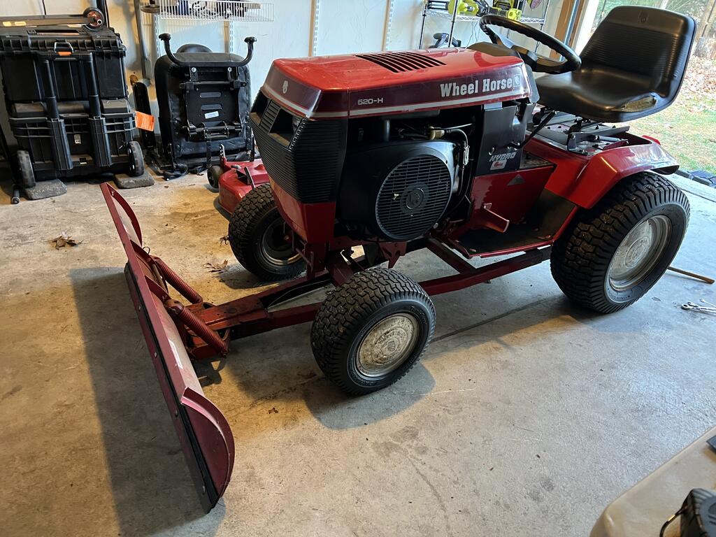

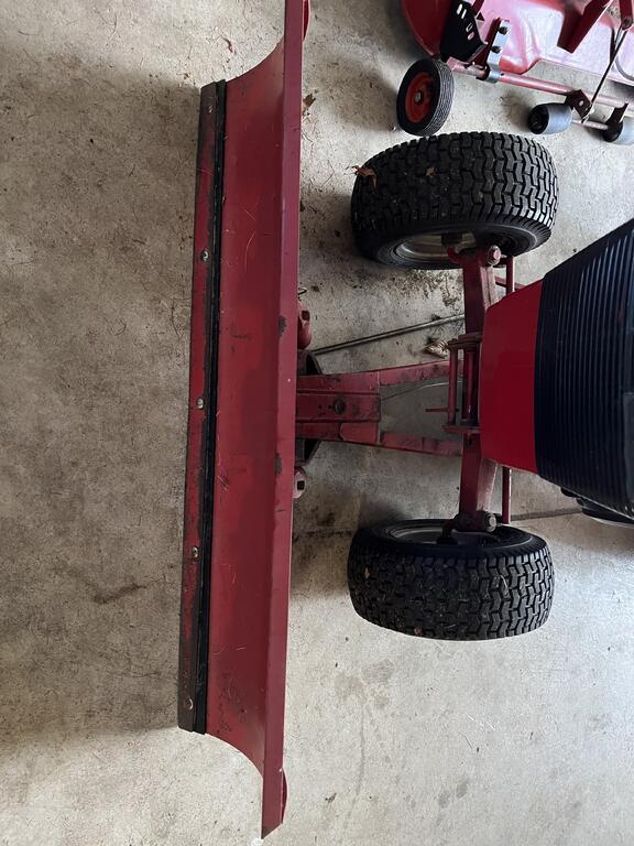

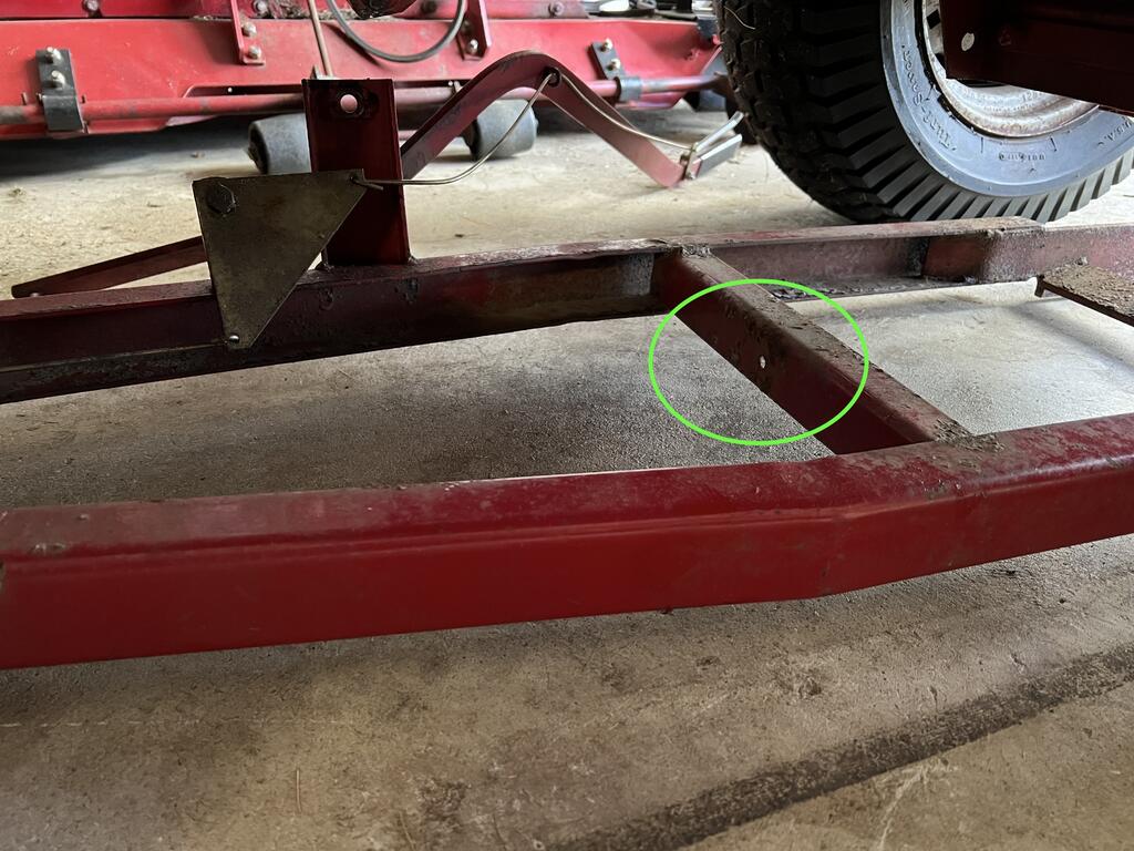

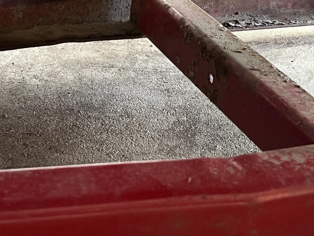

blue 3 #1 Posted November 30, 2024 Hello, I recently purchased a 520H with a couple of implements. It did come installed with a mower deck, which I recently removed and am now installing the 48" plow. I'm unable to find the serial number on it. I did have to purchase a few parts(like the rear hitch bracket and the lift linkages). 104659-with-spring-assist-bracket-108485 solid-lift-linkage-7706-snow-dozer-blade-for-down-pressure 105052-short-lift-link-for-wheel-horse I still feel I'm missing a part: Do I need the spring assist bracket as shown in 104659-with-spring-assist-bracket-108485 when mounting the plow at the rear? I feel I'm missing a link or bracket where the lift arm attaches to the plow. Pics attached. Is there anything in front to hold the plow straight and keep it rigid(other than the side to side at the front pivot point)? Three points of attachment seem low for the loads the plow could experience. Thank you. 1 Share this post Link to post Share on other sites

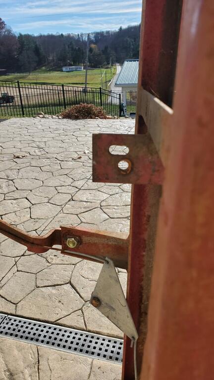

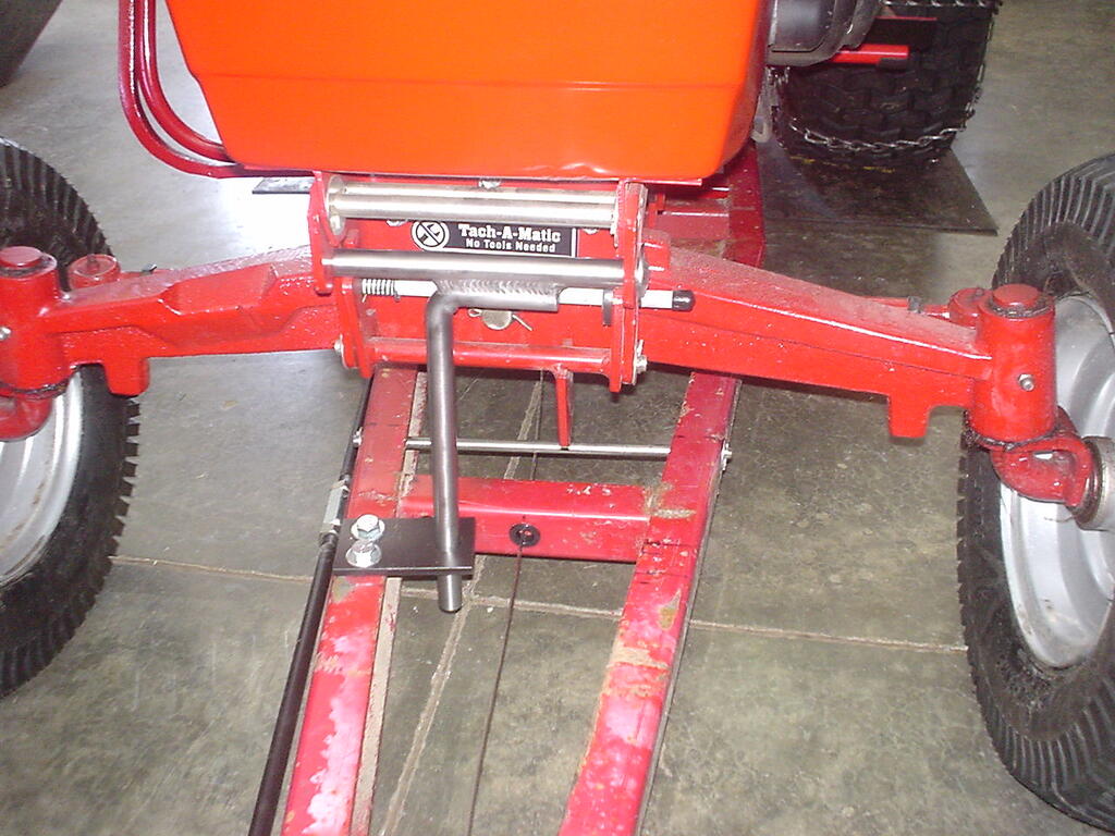

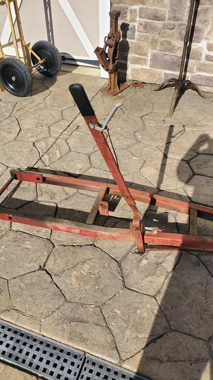

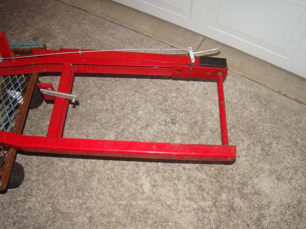

cleat 6,945 #2 Posted November 30, 2024 Here is what the lift tab on your blade should look like. Here is the manual. 3318-823 1998-2000 Blade Dozer 48in 300-Series OM.pdf I made up a front stabilizer for mine. Snow blade stabilizer.pdf 4 Share this post Link to post Share on other sites
blue 3 #3 Posted November 30, 2024 Thank you @cleat, Is there a place I can buy the little tab from? Share this post Link to post Share on other sites
cleat 6,945 #4 Posted November 30, 2024 1 hour ago, blue said: Thank you @cleat, Is there a place I can buy the little tab from? Likely just need to make one from a piece of flat steel and have it welded on. Maybe a member has an old plow frame they could cut it off of for you. 1 Share this post Link to post Share on other sites
Ed Kennell 40,395 #5 Posted November 30, 2024 4 hours ago, blue said: Do I need the spring assist bracket as shown in 104659-with-spring-assist-bracket-108485 when mounting the plow at the rear? The spring assist is really not necessary with the hydraulic lift. I feel I'm missing a link or bracket where the lift arm attaches to the plow. Pics attached. Cleat has answered this. Is there anything in front to hold the plow straight and keep it rigid(other than the side to side at the front pivot point)? Three points of attachment seem low for the loads the plow could experience. Another front stabilizer . 4 Share this post Link to post Share on other sites
blue 3 #6 Posted November 30, 2024 Thanks for pics! followup.. would anyone share dimensions of the tab and the hole layout that can be shared. Also, does it have to be welded on? thanks for the support Share this post Link to post Share on other sites

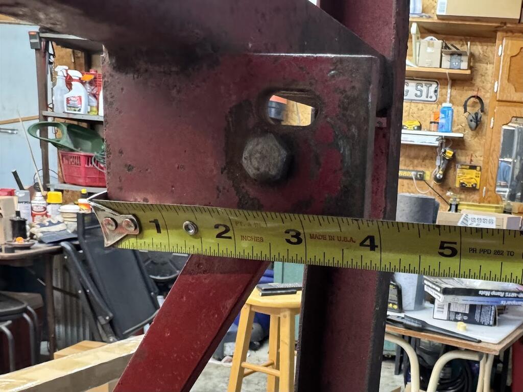

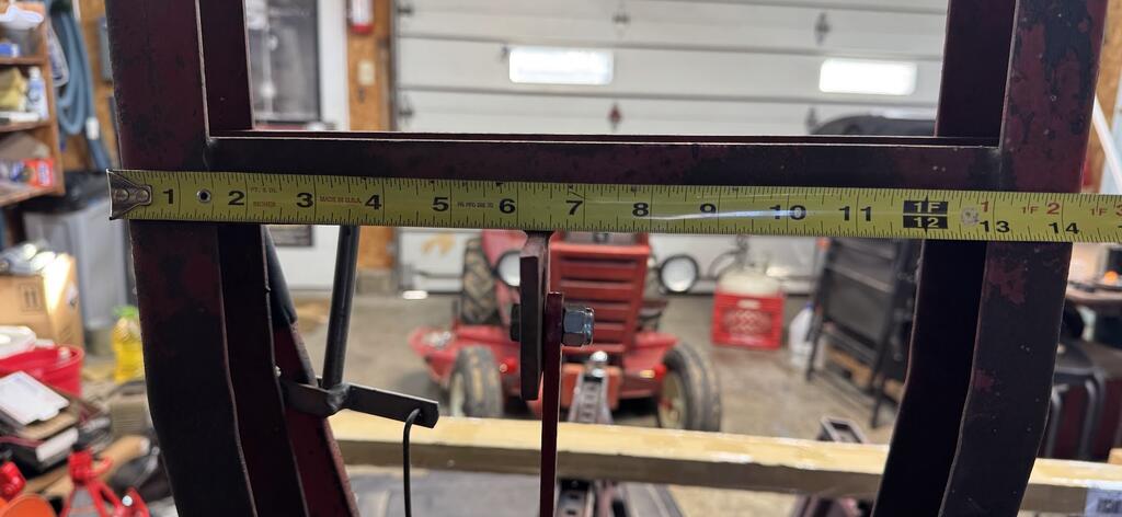

Bar Nuthin 933 #9 Posted December 8, 2024 As a temporary measure, you could simply use a short length of chain and some bolts. You won't be able to apply down pressure but at least you'll be able to move snow. I'll be working on my blade later today. I'll try to remember to get measurements for you. 1 Share this post Link to post Share on other sites

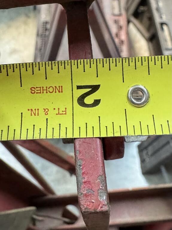

Bar Nuthin 933 #11 Posted December 8, 2024 Hope these pictures help. 1 Share this post Link to post Share on other sites
Wayne0 900 #12 Posted December 8, 2024 (edited) You could also bolt a lift tab to the frame with out much effort. 4" piece of 2x1/4" steel. All you needs is a drill. Edited December 8, 2024 by Wayne0 1 Share this post Link to post Share on other sites
blue 3 #13 Posted December 9, 2024 @Bar Nuthin Thank you for the dimensions. @Wayne0 For the short term, yes. Thank you all! 1 Share this post Link to post Share on other sites
