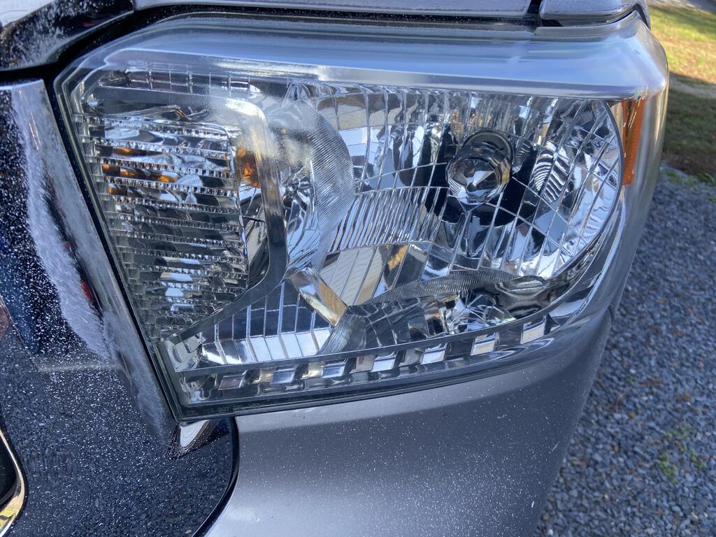

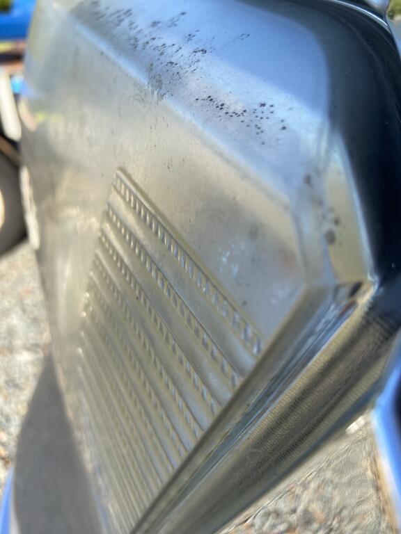

kpinnc 16,191 #1 Posted November 25, 2024 (edited) Takes a few minutes, but I found a way to bring headlights back when they get all crazed up. These are 11 year old OEM, and this truck stays out in the sun 24/7. And whatever you do, do not use the rattle can clear coat products. That stuff looks nice for about a year, and there are no second chances. The clear coat breaks down worse than the plastic itself. So Turtle wax scratch remover and my Harbor Freight handheld buffer. Takes about 15-20 mins per headlight. Makes a mess, but worth it. Just keep running the buffer until the paste dries up and clears off. Before and after: Edited November 25, 2024 by kpinnc 3 7 1 Share this post Link to post Share on other sites
Moparfanforever 896 #2 Posted November 26, 2024 Holy Smokes, what a difference!! 1 Share this post Link to post Share on other sites
ebinmaine 75,751 #3 Posted November 26, 2024 2 minutes ago, Moparfanforever said: Holy Smokes, what a difference!! What they said !!! 1 Share this post Link to post Share on other sites

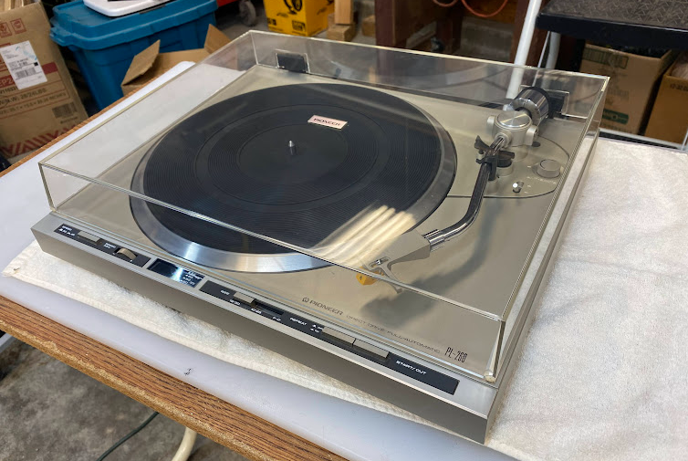

Bar Nuthin 1,810 #7 Posted November 26, 2024 1 hour ago, kpinnc said: So Turtle wax scratch remover and my Harbor Freight handheld buffer. Takes about 15-20 mins per headlight. Makes a mess, but worth it. Just keep running the buffer until the paste dries up and clears off. Same process I use on old turntable dust covers. 2 Share this post Link to post Share on other sites

kpinnc 16,191 #11 Posted November 26, 2024 (edited) 4 hours ago, Moparfanforever said: Holy Smokes, what a difference!! I expected it to clean them up a little, but was pleasantly surprised myself. I forgot to mention that the microfiber “sock” that fits over the pad makes a big difference, plus they are machine washable. Long story short, this is the same thing I used on a scratched up tractor hood. It works very well! Edited November 26, 2024 by kpinnc 4 3 Share this post Link to post Share on other sites
