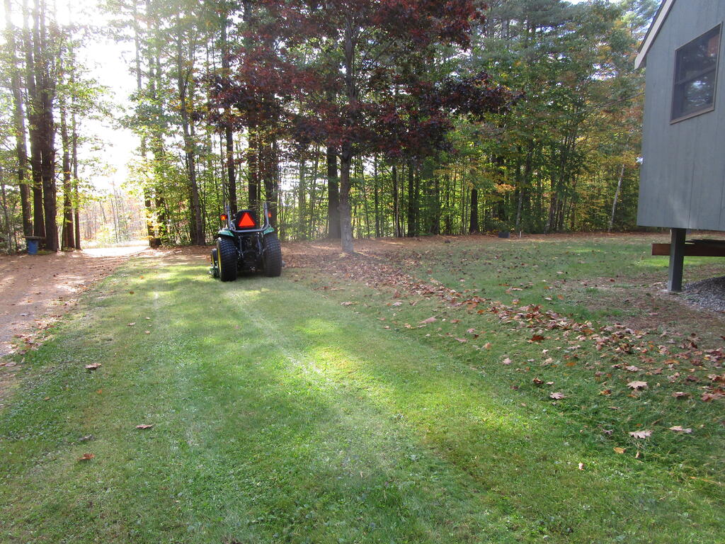

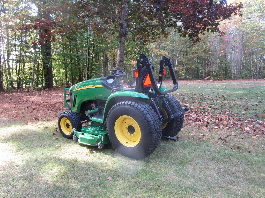

Anyone have likes or dislikes using a STIHL backpack blower for fall cleanup ?  How would it work on a 200' plus long packed crushed stone driveway removing debris ? Thus far the JD with 60'' auto connect drive on deck works great in a 3rd of the time anything else has done. Are the backpack blowers comfortable to use ? . weight. noise level etc ?  Thanks for your input.

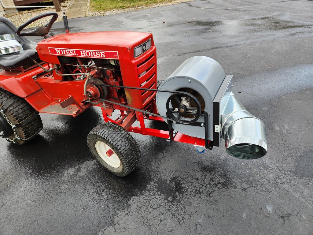

It's been too wet to try out my blower. I've got a reducer to choke it down a bit if needed. :)

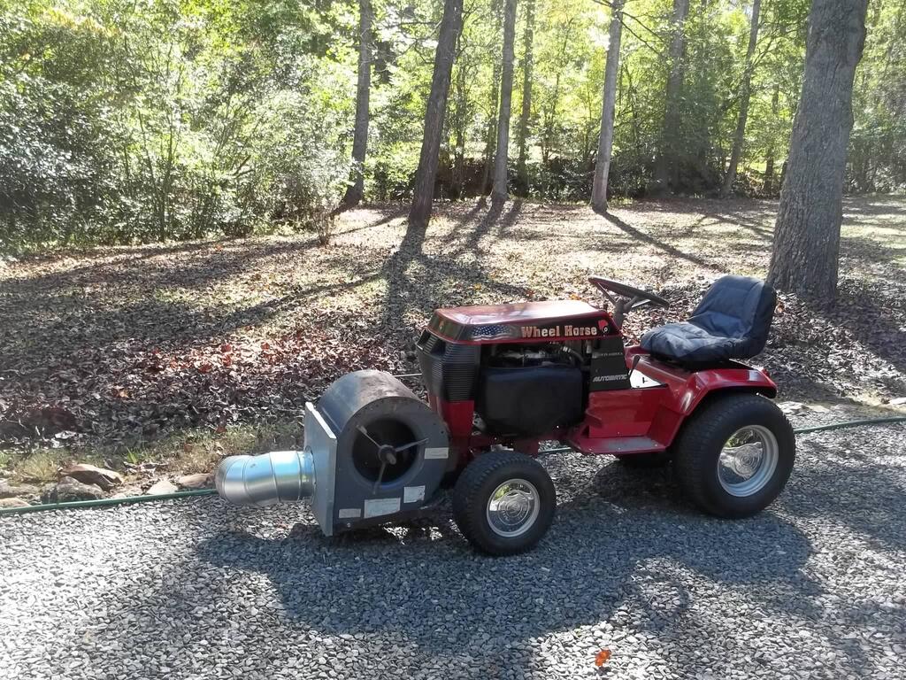

Can't say how the backpack blower would do buy my homemade Wheel Horse blower works great on gravel.
awesome - - what blower drum is that ?
The blower was installed in a commercial heat/AC unit that was being replaced. I have since replaced the round ducts wit a more compact rectangular sheet metal fabricated duct. lets me get closer to things wit5hout knocking the round duct off.

Are you using the pulley that was with the furnace blower ?

No. I'm experimenting with the diameter trying to get the blower speed where I want it at about 1/2 throttle. I have a smaller one on the blower now which should be about what I want. Close to a 1:1 ratio would do it.  :)
:twocents-02cents:       I don't think higher RPMs will be beneficial. Mine rotates at about the same speed as it did in the heat/AC system it was removed from and generates a good volume of air movement rolling a big pile of leaves as you go by. I experimented with a smaller duct size attempting to achieve greater velocity but it wouldn't move as many leaves, just seemed to generate turbulence in the fan. My conclusion is that volume of air is the key with these squirrel cage fans.
I seem to recall someone last year went for higher RPMs and the fan blew apart on them.

I'm not as much trying for a higher RPM as I am trying to get the engine RPM down some. This doesn't take much horsepower. From what I researched about 1800 RPM is about the max for this diameter squirrel cage and going beyond won't increase anything and actually can hurt. That's why I'm trying closer to a 1:1 pulley ratio. I'm not really concerned about the thing self destructing. The impeller is different than any other furnace blower I've come across. But I'll keeping it at 1800-2000RPM anyways.  Back when I did a build thread on this we discussed choking it down a bit and the same conclusion was made. I also talked to a retired tin knocker friend and he agreed. :)

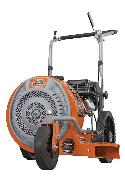

I would love to have a blower attachment to my Wheel Horse, but I "get by" with a combination of a cordless blower and a walk-behind blower.  Any blower that isn't a hand-held or back pack style isn't going to be able to get the finer, detail work close to the house.  Out in the open my walk behind works great and makes quick work of all yard debris.  I prefer the walk behind over a backpack style because of the greatly reduced noise and vibration; with having back injuries I don't like carrying extra weight around.  One can get quite crazy with blowers like this, there are ride on models as well, but this 1,200 cfm unit works great for me, sips fuel, and is as quiet as any Honda clone.  Lastly, I've rented this out a couple times which paid for it and some cold beverages after a few weekends.  :orcs-cheers:
