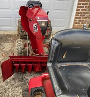

Lagersolut 722 #7 Posted November 23, 2024 1 hour ago, squonk said: Series of questions: How many hours on this engine? What is it used for? How long do you plan on keeping it? You can pull the oil pan and inspect for debris. Also check the gears for wear and play on the shafts. If they are good leave them alone. Usually there is a rattle sound in the engine when the gears are starting to think about going on vacation. 1) Hours - I really have no idea - when I pulled the head after I got it the carbon Build up was minimal and the cross hatch looked like a new engine - this unit had to be pushed onto a trailer and in my garage because it sat so long the drive belt was literally rotted off of it - only one of us here at the square would have dropped 5 bills on it the way it sat - most of the general public would have walked away …I knew what it was what I could do with it - did hear it run for 15-20 seconds - all I needed/wanted - old fuel ethanol and whatnot 2) What do I use it for - it’s now my main worker - 48 inch deck all summer - plow the garden in the fall ( does a great job pulling handling the plow ) - tall shoot for winter - 315 8 gets the blade for small snows . 3) Keeping it ? Best tractor I have - would never part with it … lol 1 1 Share this post Link to post Share on other sites
